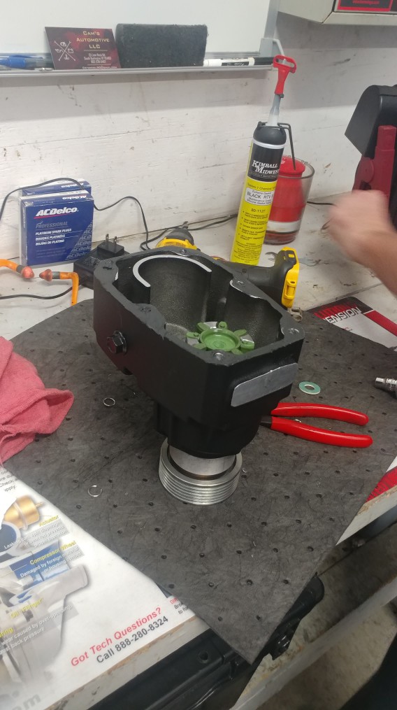

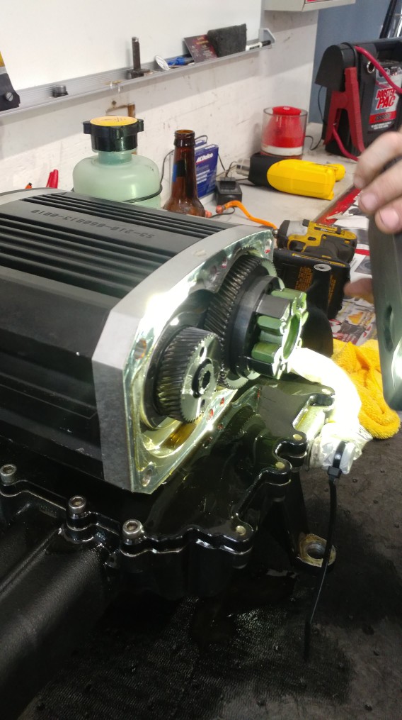

Originally Posted by 86TOYO2k17 View Post
Looking more into it, it may end up just being easiest and cheapest to get a an elbow and just use jon bond oil consumption kit if there is room to fit it under hood.
Yeah it seems like it can potentially be a pain to try and create your own pressure relief system. More time, money, and the potential that it won't actually work. The filter I jb welded has now slipped off. Maybe I didn't clean and rough up the surface of the bleeder enough to get a good bond. Having it fall into the housing would not be good!
If you look at the pictures, the fill hole is right above the gears which probably slings fluid up and out of the fill hole pretty easily. I wonder if having the JB kit up at the fill whole will push fluid up into it and potentially leak out, specially since the kit will be horizontal. This is of course if there is even space for it to fit in there. It could potentially hit the hood on acceleration even if it just clears.
The place where there JB kit is placed on the side seems to be the best place because there is that semicircular aluminum casting that keeps the fluid from slinging into the kit.

Originally Posted by jflogerzi View Post
You tap the metal plate on the left side of your facing the SC. The job bond kit is exactly this. Brass 90 elbow and a metal catch can with a filter at the top...
Sent from my ONEPLUS A5010 using Tapatalk
Yeah man, I was trying to do a quick solution to help vent pressure without having to pull out the snout if I didn't need to. Seems like the fill hole might not be the best place based on the placement.
BRZ_F is offline   Reply With Quote
Attachment 178373
Attachment 178374
interesting never seen in one of those. would it be stupid to take that snout of with the charger/manifold and everything on the car? I got no issues with my kit so i dont know how much i want to mess with it, a quick easy solution i wouldn't mind. but if its easy to get the snout off with out having to take the manifold off, maybe ill consider.
86TOYO2k17 is offline   Reply With Quote
I think it's pretty easy to remove the snout while the sc is still on. Remove the belt and the 6 bolts and tapping off the snout. Then cleaning the surfaces and using an anaerobic gasket, that comes with the JB kit. It doesn't seem very hard, I was just trying to avoid having to do it. But it could be worth it to keep the seals from blowing out over time and having fluid get past them.
