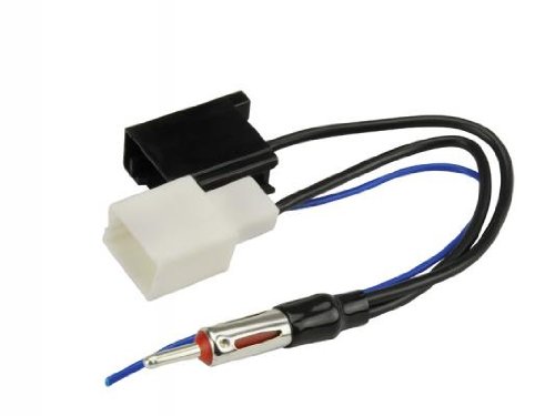

After reading this thread - I still can't figure out exactly what I am in for.
I ordered this:
I am assuming I will have to plug it into two of the dangling BRZ connectors and then into the radio antenna plug on the ca-fi

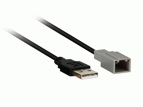

I also ordered this:
Which I am assuming I plug into the dangling USB cable on the back of the ca-fi and then into the factory connector that goes down to the USB connector near next to the 3.5mm aux in.

My OEM+ harness will just plug into the factory harness and then into the connectors that feed the ca-fi - correct?
Fastbrew is offline   Reply With Quote
I ordered this:
I am going to forget about the 3.5mm aux in - I won't use it.
Is that it? Is there anything else?
Those appear to be the correct parts (can't know for sure without model numbers, but it does appear to be correct from the pictures). If you're not looking for Aux to work, that should be all you need.
Yeah, if you have a BRZ you don't need to plug in that blue wire just plug in the 2 adapters and plug in the one banana plug into the HU. Also, plug the USB adapter into the USB port that is attached with the iPod connector, not the hard wired USB cord on the HU, that's for the WiFi adapter.
