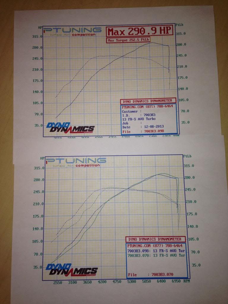

I was having slight stumbling issues with throttle tip in. I also had another one of those rolling stalls due to my light-weight flywheel. Brought the car back to PTuning and got the following results with the new catback exhaust.
I lost a small amount of top end but the low end torque has increased quite dramatically. The torque delivery is far smoother as well, which should help a lot with usable power at autocross.
