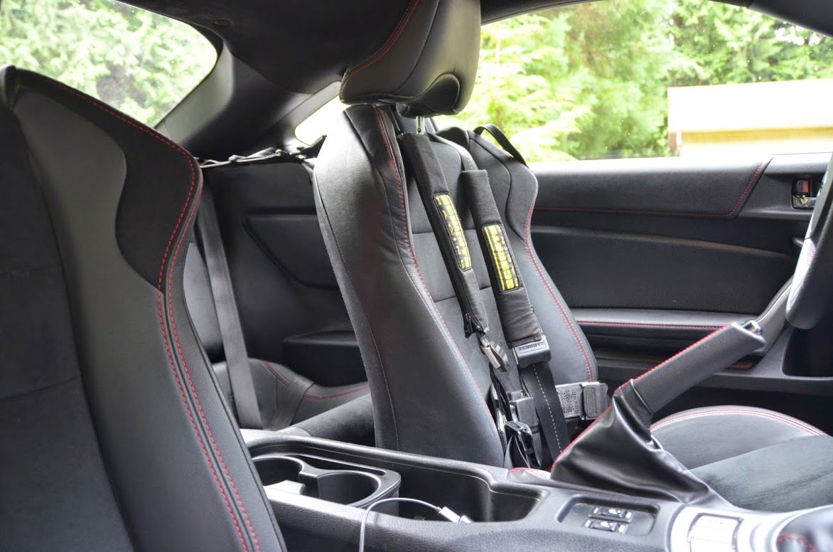

100% stock interior. The OEM seats are spectacular in this car, and will hold you in place rather well. I personally would never recommend a harness and harness bar with OEM seats.
I'd like to know why you don't recommend harnesses in OEM seats.
I've been eyeing the Schroth Rallye 3, a 4-point harness designed to anchor to the rear child seat anchor.
Your thought's on this are much appreciated.
N234 is offline   Reply With Quote
Old 04-29-2015, 02:33 AM   #79
CSG Mike
CSG Mike's Avatar
Drives: S2000 CR
Location: Orange County
Posts: 14,564
Thanks: 8,942
Thanked 14,213 Times in 6,856 Posts
Mentioned: 970 Post(s)
Tagged: 14 Thread(s)
Attachment 108236
I wouldn't ever use that. That's asking to submarine.
Also, the only POSSIBLE way for that to be effective, is if you're a midget. Seriously.
The Following User Says Thank You to CSG Mike For This Useful Post:
kravi (01-16-2016)
