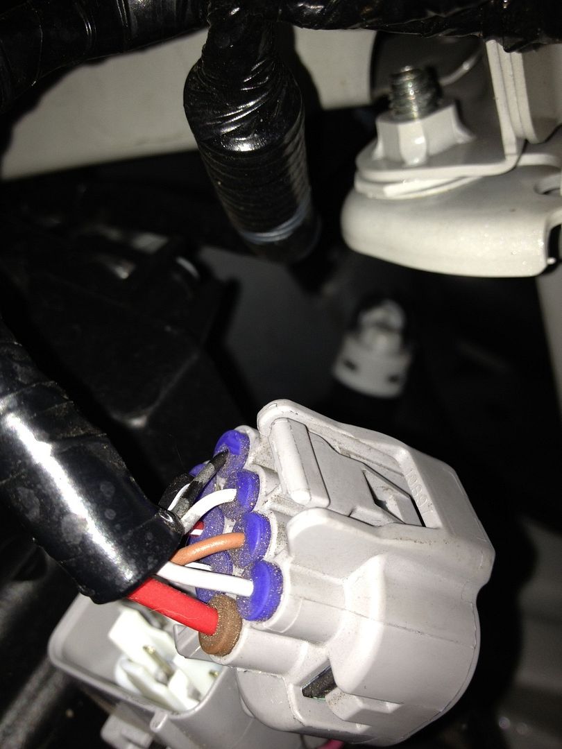

The plan is to rewire them with a relay. IGN on, DRL in high/bright mode. Headlights on, DRL in low/dim mode. Got that part figured out, I just don't know what the pins are on the headlights so I'd have to sit with a multimeter and test.
I'm also trying to source a "jumper cable" that fits between the headlight and harness so I wouldn't need to cut any wires. Zero luck to date.

Here is the connector:

Originally Posted by GeeTee86 View Post
they do make up wiring kits, just not sure if they would have those connectors
That's the problem. I've been through almost the whole of Alibaba.com without any luck.
I'll contact the headlight manufacturer and ask if they could provide something.
