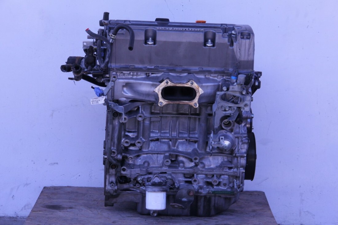

Yeah, I don't know. The 2AZ is inline and the K24 is at a slight slant, so that could help, but I still don't think it would be enough for the same hood height. From what I read, he used a bellhousing adapter plate, so that is likely less than an inch, and he mounted it to the stock transmission, so unless he mounted the engine high and the transmission is pointing down, the engine fit fine without the need for a custom oil pan. In fact, maybe he would have needed to make custom transmission mounts if he was going to drop the engine lower. In the Kpower blog they mentioned not just moving the transmission back, but also down.
No, he said it sits up high because he only had an OEM FWD oil pan to work with. He explained that a custom oil pan would let it sit much lower. I messaged him about the swap because it was super cheap <$3000 but it doesn't really fit. Fit means it sits in an engine bay and the hood closes...
I don't know about the firewall. It wasn't a for-certain thing. I would have to imagine that it isn't just about the firewall, but the distance from the nose or start of the crumple zone to the engine and the distance from the engine to the firewall or the driver. As far as the Miata, it is hard to tell. The Miata has a strut bar over the back of the engine, so it looks closer than it may be, and the head and valve cover kind of protrudes beyond the bulk of the longblock, as seen below, compared to the K24, which has a fairly flat backside once some coolant lines are maneuvered, so again, it may look further back than it actual is.
I guess one thing to compare if the Edelbrock kit and the K24 positioned in these pics, and the thing to note is the Edelbrock supercharger requires the removal of the hood heat shield for clearance.
Look, coming from a Supra world, I would love an engine bay that looks like this. Sign me up:
https://engineswapdepot.com/?p=57004
I've talked to the owner of the 2ar swap. He said it sits up high because he only had an OEM FWD oil pan to work with. He explained that a custom oil pan would let it sit much lower. I messaged him about the swap because it was super cheap <$3000 but it doesn't really fit. Fit meaning it sits in an engine bay and the hood closes...But as you see it can fit just fine in an OEM like location like every other I4 you have seen.
