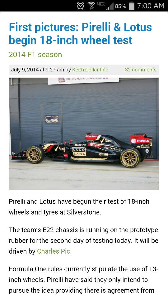

those look HUGE
not sure how I feel about them...

Here's a thought: If they actually go to these size of wheels, would braking distances decrease due to more surface area & cooling? I know the suspension would need to be more compliant.

I remember reading that they kept the 13'' wheel size to limit the brake size.
I would assume breaking might be improved if they switch to 18'' wheels if the rotors grow the same amount.

No improvement in braking distance which is currently limited by the amount of grip the tire provides.
Larger surface area and better cooling will mean less fade and wear over a race so they can be more aggressive on the brakes, might be a leg up for the likes of Alonso and Hamilton who will have more leeway to dive into corners aggressively. Talking about preserving the brakes may be a thing of the past.
The biggest difference will be in the tires, they'll have to be much stiffer resulting in softer suspensions. The cars are going to move around a bit differently, the slow-mo comparisons will be fascinating.

I agree. The ONLY reason for larger wheels in motorsports is so that larger brakes can be fitted, otherwise most cars in most motorsports would run smaller wheels. So if they're just increasing the wheel size, just to do so, that would be really F'in stupid and it would give me another reason to replace my DVR space with Indy instead of F1.

I thought cooling wasn't really a problem with the ceramic brakes?
If anything, the bigger wheels will cause more aerodynamic drag and slow down the cars that way Decreased braking distance, marginally.

The brakes used on F1 cars are carbon, not ceramic if I'm not mistaken. They need to get very hot to work properly.
The wheel size limiting braking was something that was put it place a long time ago when F1 brakes were very different.
I'm not sure if enlarging the rotors and brakes will give improvement, with today's brakes and materials. Maybe they might be a lot lighter.
