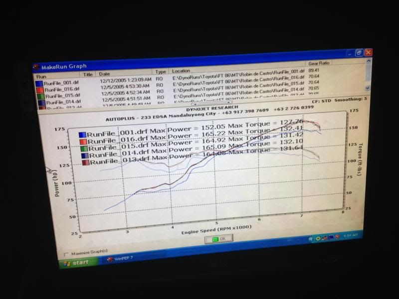

Dynoed my car today...
Dynojet
34C Ambient temp
55% Humidity
runs done on the same day
Blue line: Milltek overpipe, resonated front pipe, resonated catback, Afe Takeda dry intake, Borla UEL header, stock ECU
Red line: same as above except with Unichip
[IMG]http://i374.photobucket.com/albums/oo184/mtech2/image_zpsac***fbe.jpg[/IMG]
13whp gain with the Unichip and yes, the runs were pretty consistent:

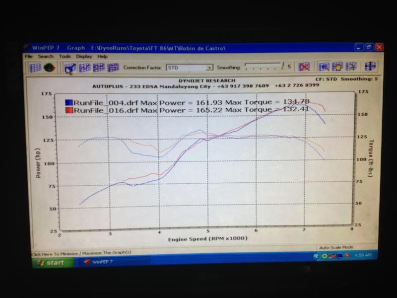

And here's today's best pull overlayed next to my bext pull last month. Blue line is with the same mods except for the header.

Nice robin! Big gain on the torque on headers. Ftw
