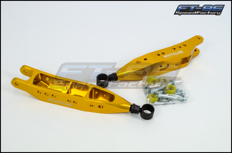

So I pulled the trigger on konis and RCE tarmacs, my follow up question is regarding LCA's. Am I correct in assuming that if I were to use the Whiteline LCA's that have multiple mounts for the rear sway bar bushings, I would only be legal in STX if the bushings were mounted in the same location as on the oem LCA? I attached a picture of the Whiteline LCA from FT86SF.

The allowance is about Camber, not anywhere else in the rules. So that's where it starts. Does the arm adjust camber? *yes* Does anything else in the rear of the car need to be modified to use your part? If that answer is no, you're golden. Bushing rules are bushing rules. Those rules never talk about relocation, just about material and type. No additional metal, no change in type. Also means no camber plates at the top of the strut.

I think his question was referring to the option the Whiteline arms give with having 3 mounting points to modify motion ratio as well as 3 options of where to mount the swaybar link. Of those 3 options for both connections one of them is the stock geometry.
You can not change motion ratio, of course, so if you are using the stock mounting hole for the strut I would see no benefit in using anything other than the stock location swaybar hole. You would be moving the endlink off center from the swaybar rather than adjusting the arm length or anything.
Also, the bushing rule for anti-roll bars is different than suspension arms. Bushing material, method of attachment and locating points are unrestricted as long as you don't cut holes to route bars or links, or modify suspension locators that would effect suspension and steering geometry.
They also stipulate routinely through the rules that you cannot change suspension geometry. So I was trying to see if that would be considered changing the suspension geometry.
