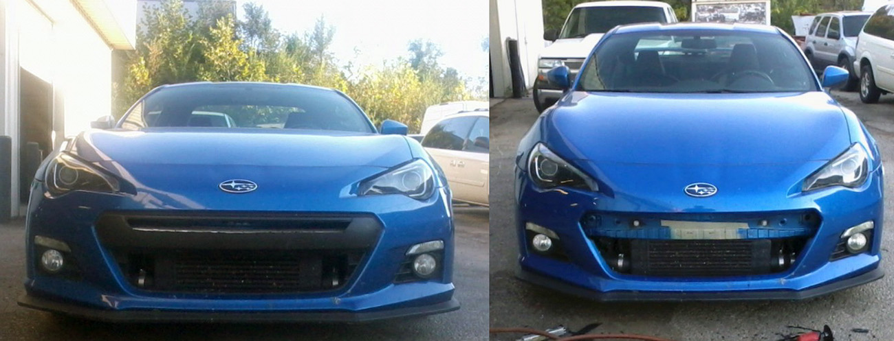

In the meantime I've been playing with airflow since my 2nd project allowed it. My first try was cutting out a slit on the BRZ's mustashe (along the body line) to increase airflow. My theory was that the intercooler was buffering out airflow that my a/c and radiator were once getting full advantage of. My just happened to come right above the OEM low-speed impact foam asorber and just below the full blown intake's location~ Perfect! A quick test and I didn't really notice anything, slightly cooler but as I was doing the test the sun was setting and the temp slightly with it.
My second try was removing the the foam crash asorber and cutting out the grille. This made a huge difference suprisingly... which I wasn't expecting since I didn't remove the OEM crash bar itself. I'm guessing this allowed air to flow wherever it could go after hitting the metal crash bar.
I decided to take it a step further and completely cut out all of the OEM black grille. The top mustashe and the surround that made up around 2" of the surface area. This made a ungodly difference. Having cut out the lower grilles surround meant my oil cooler behind the foglight was getting air for the first time. Remove the upper mustashe gave a huge increase in incoming airflow. Allowing air to move OVER the crash bar and directly to my radiator in addition to through the intercooler that way. With this setup I could hardly get the car warm enough. 20min of highway driving and back-to-back pulls and I could barely get past 176FF... when I stopped and idled at the lights the temp would climb but soon as airflow hit the front oil temps dropped to right at 180F.
So with the front completely removed I also enounters crazy pressures resulting in my hood fluttering any time I approach 75mph+. The varis hood should take care of that allowing the air somewhere to go. In the meantime I pulled a page from Reaper and remove the rear hood seal.
So slightly overcooling, lack of engine bay venting and the front looks like poo when your closer than 10' away. I'm faily certain I've got this part beat and can hit the track next year with zero fear. Hopefully I can finish up my custom grill to knock back the overcooling and my hood to show up to solve the pressure venting(as well as help reduce temps while stationary.
