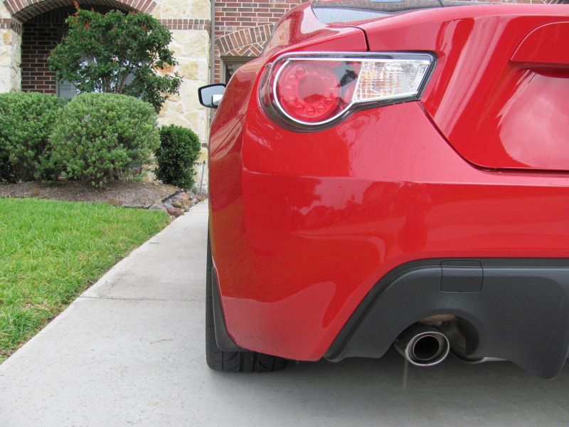

Nameless Axleback Update
Spoke with John @ Nameless yesterday. My AB unit will be replaced with a new unit, possibly with a braided flex coupler to alleviate stresses caused by variances in the factory midpipe flange angle. He plans to have several cars in for test fitting and proceed from there. They will cover shipping of both units. The unit I have now will be modified and put up for sale on their site as used at a discount.

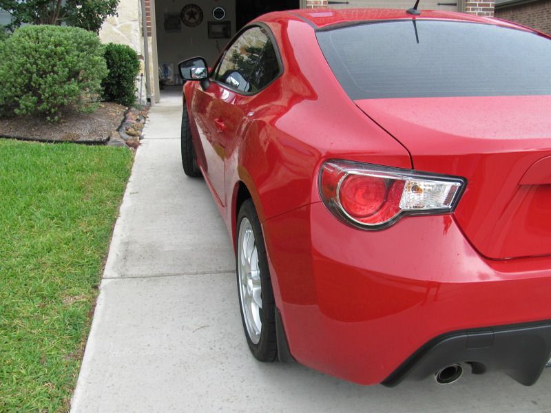

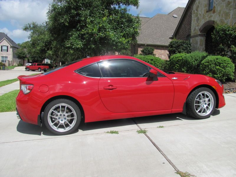

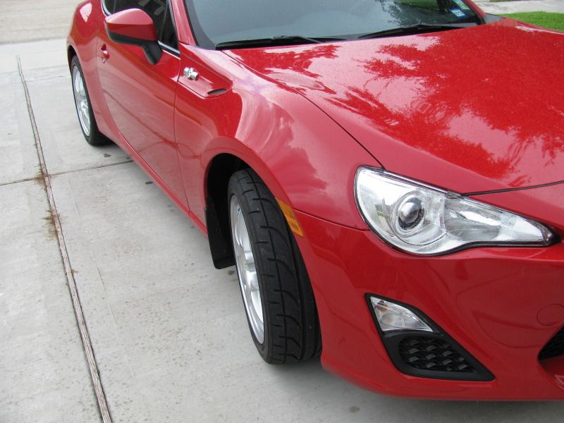

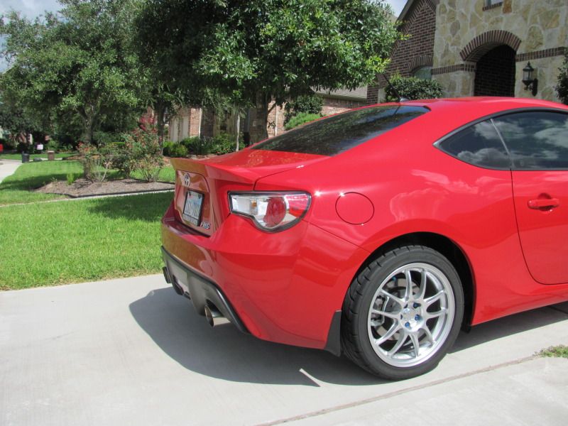

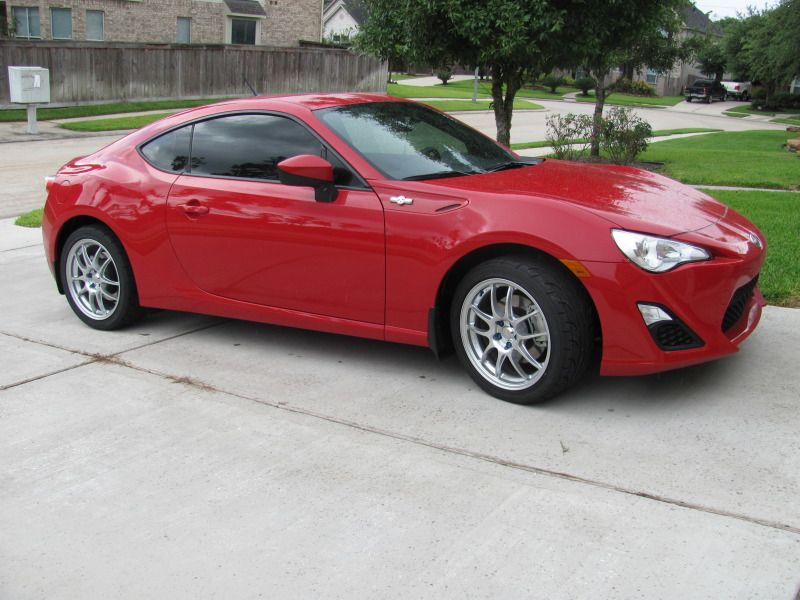

Thanked 142 Times in 90 Posts
Originally Posted by gmookher View Post
where did you score those lugs nutz?
IIRC, these are McGard spline drive, and I bought them on Amazon. The "cone" that contacts the wheel runs on ball bearings, so it doesn't scuff the aluminum as you torque them down. I think they were ~ $80. for the set.
I'm still very impressed with the suspension on the 86. I haven't tracked the car yet, but it seems harder to break the tires loose in a turn than my NC miata running the same size Star Specs with a fairly aggressive alignment, plus it stays surprisingly comfortable loaded down during long road trips. It also seems that the suspension has settled a bit, sitting a bit lower now. As of now, I don't think I'm going to install coilovers, as it would be very difficult to improve on the stock dampers for my use. I may go to urethane sway bar bushings after I get a feel for the roll/tire wear on track with the Star Specs, just to tighten it up a bit more to compensate for the extra grip. A bit more negative camber would probably help with tire wear and grip on track, while not eating rubber on the street. We'll see, but I'm really happy with it for now.
