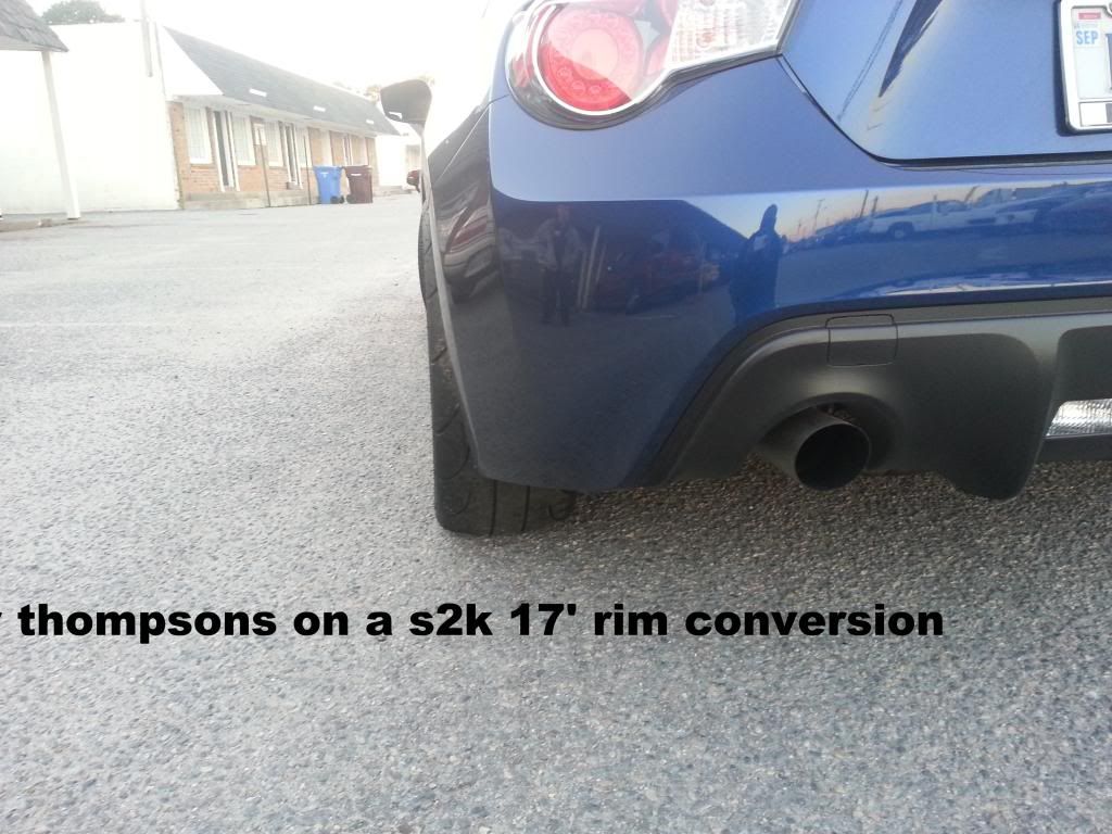

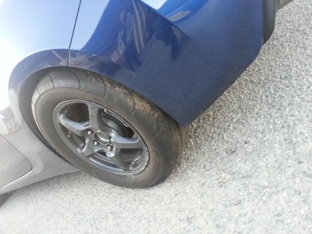

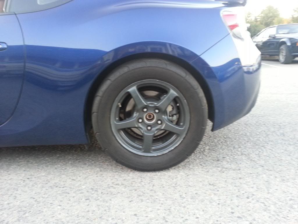

[IMG][/IMG]
[IMG][/IMG]
[IMG][/IMG]
These should solve my traction issue

Old 11-19-2013, 11:41 AM   #67
Ross
Drives: 85 corolla gts
Location: Chesapeake , Va
Posts: 361
Thanks: 17
Thanked 177 Times in 110 Posts
Mentioned: 26 Post(s)
They do hook pretty good
Ross is offline   Reply With Quote

which built motor?
@Fabron757 running adapters or are they 5x100 ?

Old 11-19-2013, 11:44 AM   #69
Ross
Posts: 361
Thanks: 17
They are hub eccentric adapters till we can find wheels in 5 x 100 that are offset correctly.

Holy crap we're twins in the rim and tire department!!!! Mine are 16" though and I'm running adapters. What size tires are they?
