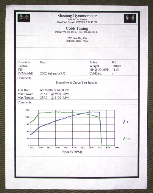

Originally Posted by Ryephile View Post
...I'm proposing using the meat of its VE band; 2500-6500.
Like this?
2.0L, open deck, full exhaust, one cat, silicone(!) intercooler y-pipe, stock airbox, stock air filter, non variable cam anything, 93 octane, Unichip(!!!)
Sure, power drops off pretty quickly after 6000rpm. That's the compromise of a small, responsive turbocharger. Oh, and speaking of responsive, this tiny turbocharger produces positive boost at 2000rpm. I can just tip in with throttle in any gear and the motor is in boost, even in top gear. During a long road trip where the gas is anywhere from 93 down to 90 octane, it averaged 36mpg - in a 3200lb car.
Before anyone says this is a noobie kit or that it only appeals to folks who have never driven a "real" car, or that this is under-engineered, this thing was very fun on the street and great at auto-x. I wouldn't say that this is the only power curve that is good, so let's not claim that only our poop doesn't stink.
The keen-eyed may notice that we stopped the dyno pull short of 7000rpm. Beyond 6750, there was very bad spark breakup. We changed everything we can and it came down to the lightweight non dampened pulley. We swapped the stock one back and no breakup. Swapped a different lightweight one, and breakup. So....at least on a 2002-2003 WRX, I'd say no lightweight pulley.
So a modern motor with direct injection and full control of valve lift and timing should be far, far better than what I had right? Right?
-budi
buditjoenawan is offline   Reply With Quote

Looks excellent. Thanks for sharing.

Originally Posted by buditjoenawan View Post
Like this?
-budi

Originally Posted by raul View Post
Missing the point. The car's NATURAL torque kicks in at 4.5k+ RPM. He's essentially asking for a completely different kind of powerband. It's an engine meant to be revved high, which means downshifting for power. It's as simple as that. Sure, it's responsive all around, but when you put your foot down at 2k you barely feel it. It doesn't mean you have delayed response, just means you don't have the torque the OP describes he wants.
You may want a refresher on what the stock torque curve looks like:
Looks to me the natural torque curve "kicks in" at 2500 RPM. I'm looking to shelf that up. We've seen good results with some boosted setups where the infamous 3500-4500 RPM torque dip can be tuned out.
We're going to have to agree to disagree that this engine is "high revving". My 2ZZ-GE revs to 8500 and my motorcycle revs to 13k. Those are engines that need downshifting to access their torque peaks.
That spike in torque isn't usable with the famous torque dip our engine has. What you are looking for is essentially to get rid of the torque dip, which is different from the car's current character. It'll change how you drive the car altogether.
And well, high-revving is relative. So there's really no point discussing that one. The point is that you currently have a usable torque band from 4.5-7.4k RPM, but you want to move that down the range to say, 2.5-5.5k. You may have bought the wrong car my friend.
.... What you are looking for is essentially to get rid of the torque dip, which is different from the car's current character. It'll change how you drive the car altogether......
TAA DAA! You're right, it'll change it from sucky to useful.
No idea how you can rationalize a stock torque band goes to 7400 unless you're using a dyno graph made from Crayola. The torque plummets over 6k and the airflow is dead at 7k.
Please re-view @buditjoenawan's post, as he nailed it.
