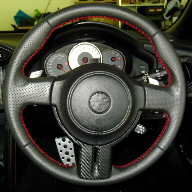

I finished off the CF Vinyl wrapping today.
First of all I tackled the steering wheel plastic.
I removed the airbag using this DIY tutorial:
http://www.ft86club.com/forums/showt...airbag+removal
Thanks @Synack
The only slight difference I found was that there were only three holes in the steering wheel (3, 6 & 9 O'Clock).
I used a thin bladed screw driver and managed to push on the 'spring' first time. I needed to release the springs at all three holes to get the airbag to come off. Also I didn't bother disconnecting either the horn fuses or battery, I only set the horn off twice (once during removal, once during fitting). I also left the wiring connected to the airbag and simply moved it out of the way to access the screws.
Upon removing the airbag there are two screws that you need to undo at the 3 and 9 o'clock positions

Upon removing these two screws there is a clip on the lower spoke of the plastic but this pulls out very easily.
This is the plastic removed from the wheel.
This is what it looks like after about an hour of heating and stretching, heating and stretching, heating and stretching - you get my drift and reinstalled.
To refit the airbag into the steering wheel after replacing the plastic I found that one good push on the airbag/horn clicked it right back in to place. No problems.

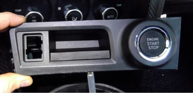

The only difficulty I had with this was getting the USB/Storage Hole/Starter Button Panel out. In the end I ended up pushing out the USB port, as this is all I could touch with the limited amount of room behind the panel. Upon removing the USB port I disconnected the wiring, pushed the wiring back into the centre console and then hooked my finger through the empty USB hole and managed after a couple of attempts to get the part out.
It is held in by 6 rather large tabs, one of them sustained a small amount of damage coming out (centre one) but it did re-engage fully upon replacing it.

Part of removing the USB/Storage/Starter meant removing the gear stick surround again. I found the easiest way to remove it from the console was by putting a trim removal tool in here:
This then pops the two retaining clips that holds the surround down (the two cream/white clips at 8 & 10 O'clock).
