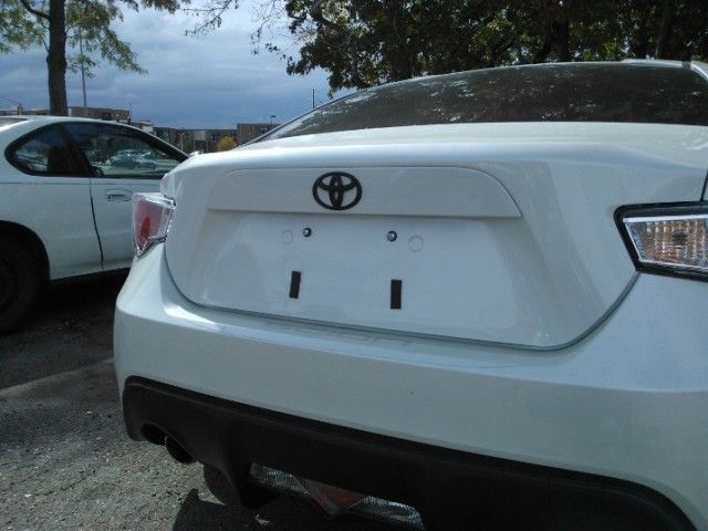

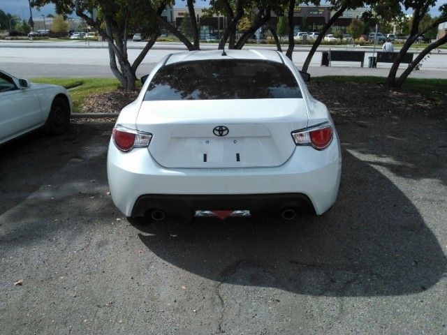

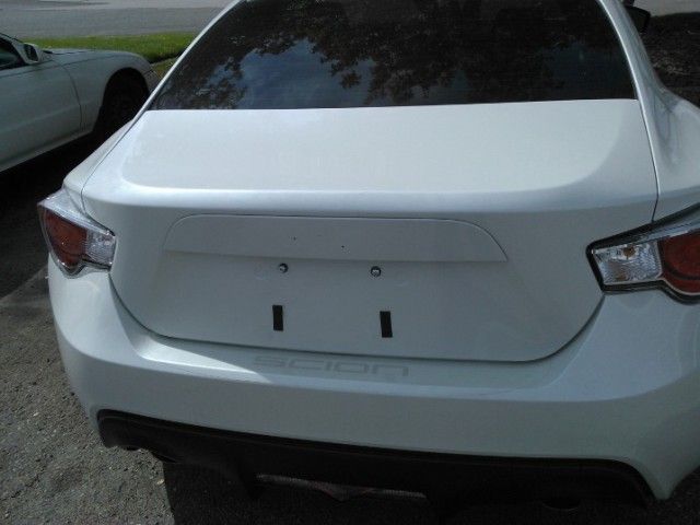

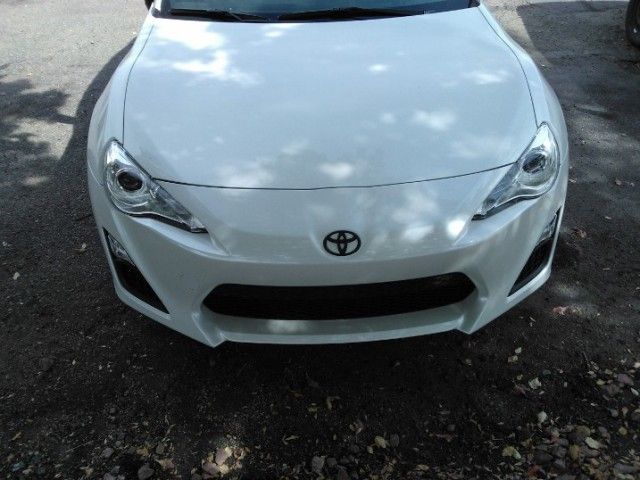

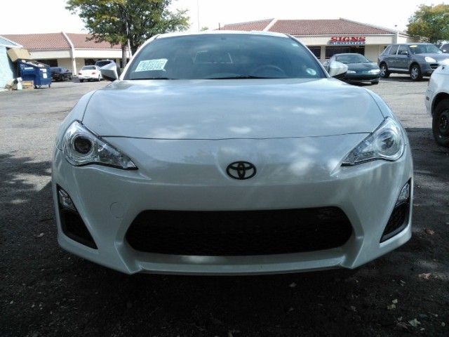

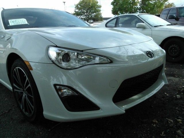

Originally Posted by VietnamPhenom View Post
I just got the Corolla and Avalon rear emblems today. Lucky for me, I work for Firestone. So, I got a discount an 10% over cost. I wanted to change mines up a little bit, and I plastidipped them black. I want see you guys opinions. I'm at a 50/50. If I don't like them, I can always peel it off back to chrome.
black and white always looks good. i just plasti dip'd all my emblems on my asphalt fr-s. 86 piston padge and everything lol.

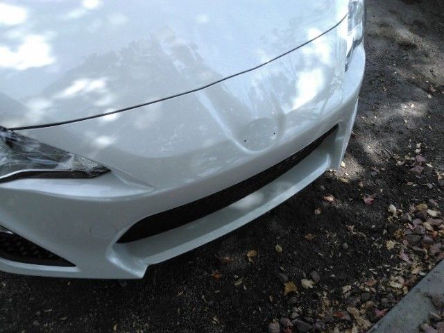

Can someone who has changed their emblems give us a detailed desription of removing the old ones without damaging the paint?

Car color is Raven, let it sit in the South Florida sun for 30 minutes.
I wet the area with hot water from the tap.
I put on thick gloves and wrapped 8 lb test fishing line around my fingers, slid it behind the emblems and used it like a saw. It took about 1 minute per emblem to break lose the emblem.
Grabbed it with my ungloved hands and peeled it off slowly.
Bathed the area in Goo Gone, let sit about 30 seconds, rubbed with a hot water cloth.
It came off very easily, almost like rolling up taffy.
I cleaned the area with Dawn dish washing soap, dried it, waxed it with Turtle wax.
This is how I did it, I'm sorry if I upset those who don't like my method.

I used 3M Adhesive/Wax remover. The rear emblem I just pryed off by hand and it came clean off with no adhesive residue. The front, I had to use the 3M adhesive remover and used my plastic decal removal tool.
