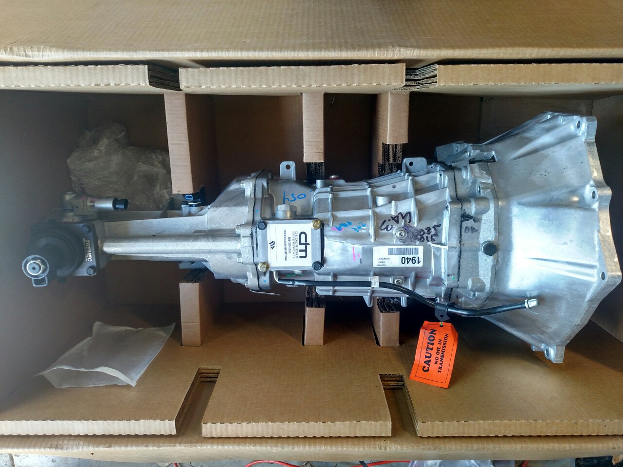

some assembly required. lol

some assembly required. lol[/QUOTE]
You lucky bastard. Mine should be in Wednesday or Thursday

It arrived early.
