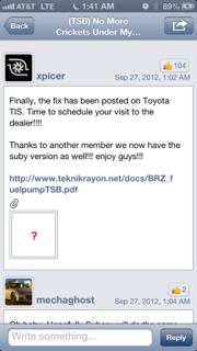

Originally Posted by kramerica_industries View Post
Attachment 20671 this looks like the BRZ bulletin to me
Check the link in my sig
And yet, Scion's TSB is also there.
