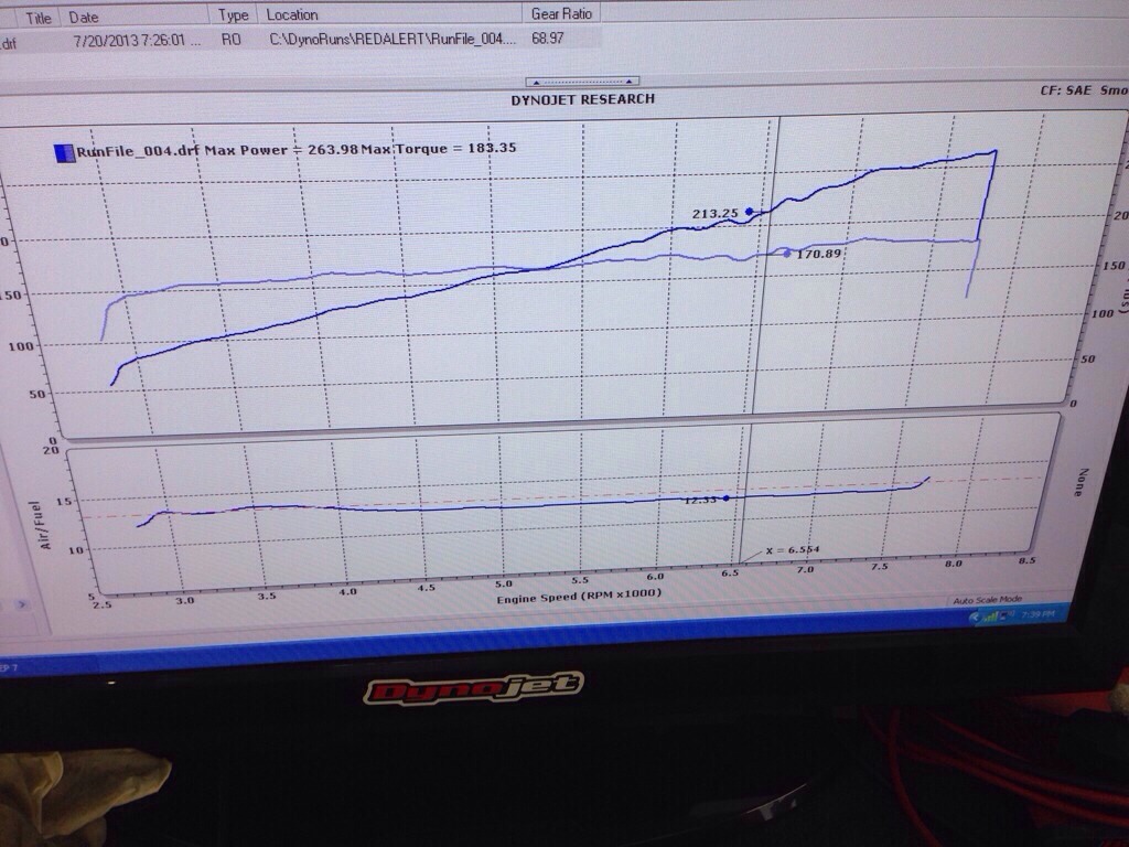

Yum

New basemap?

I've been working on Vortech stuff all week, so just a update I've come up with
