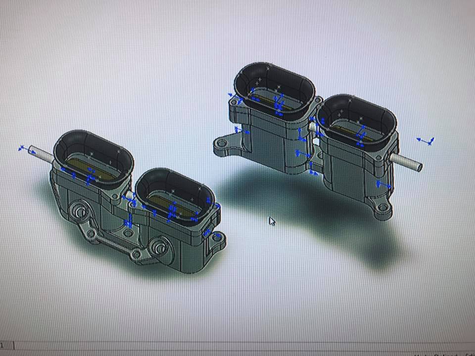

Old 06-20-2017, 09:58 AM   #586
laextreme5
laextreme5's Avatar
Drives: 2014 BRZ
Location: Louisiana
Posts: 178
Thanks: 31
Thanked 122 Times in 67 Posts
ITB setup looks great, any shots of how it will all be laid out?
laextreme5 is offline   Reply With Quote
Nothing physically on an engine its all virtual for now.
What about this?
https://r.tapatalk.com/shareLink?url...re_pid=2919437
Sooooooo it's been a LONG time since an update.
Been super busy between multiple projects but here we go.
I finally taught myself enough Solidworks to produce what I needed pics att......
I apologize for the shitty Tapatalk copy/paste.
Sent from my Pixel using Tapatalk
