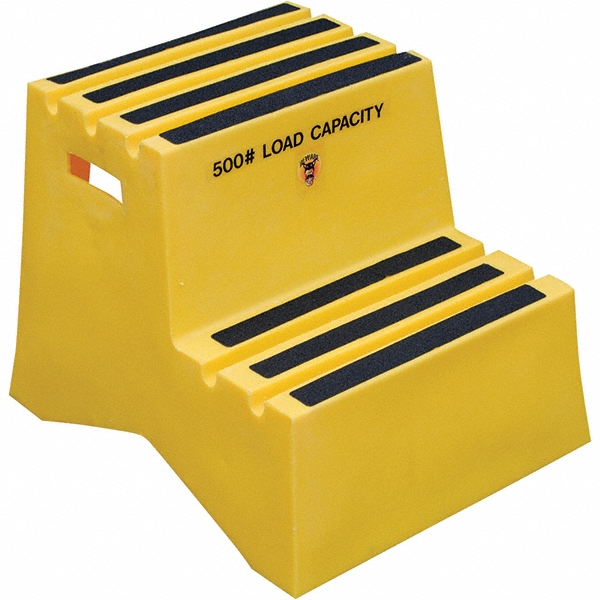

Old 02-06-2023, 12:59 PM   #5839
spike021
spike021's Avatar
Location: San Jose, CA
Posts: 5,846
Thanks: 14,219
Mentioned: 72 Post(s)
Once I install my yellows I can send you my OEMs in the event that you don't have them anymore. I'm probably going to also get the Bilstein shocks and just do everything at once.
Oh thanks for the offer.
I should correct what I said earlier; I have my OEM springs (I never get rid of my OEM parts).
I just wish I could go back to them for the softer ride but still prefer the fun of the Yellows haha.
Instagram: @spike.grc
spike021 is offline   Reply With Quote
The Following 2 Users Say Thank You to spike021 For This Useful Post:
spcmafia (02-06-2023), Ultramaroon (02-06-2023)
Old 02-06-2023, 12:59 PM   #5840
Clipdat
Proud of BOXER
Clipdat's Avatar
Drives: Subaru Boxer
Location: Bay Area
Posts: 8,152
Thanks: 7,087
Thanked 6,872 Times in 3,680 Posts
Mentioned: 199 Post(s)
I went through three different suspension setups and four different exhaust setups on my first twin.
Originally Posted by humfrz
I'm old and lazy
Old 02-06-2023, 01:08 PM   #5841
bcj
Geo Tyrebighter Esq
bcj's Avatar
Drives: '13 scion fr-s
Location: pnw
Posts: 4,316
Thanks: 6,707
Thanked 5,260 Times in 2,291 Posts
We blew a line in the air shifter because they used barbed fittings with hose clamps.
Air brakes too? Fancy!
Yes, the same exact report had to be submitted in 2 formats.
✌️ Engineering air quotes was in it's infancy. ✌️
The Following 2 Users Say Thank You to bcj For This Useful Post:
Spuds (02-06-2023), Ultramaroon (02-06-2023)
Old 02-06-2023, 01:08 PM   #5842
spcmafia
spcmafia's Avatar
Join Date: Jun 2020
Drives: 2018 Subaru BRZ
Posts: 3,397
Thanks: 1,566
Thanked 4,242 Times in 2,052 Posts
Mentioned: 26 Post(s)
Oh thanks for the offer.
I should correct what I said earlier; I have my OEM springs (I never get rid of my OEM parts).
I just wish I could go back to them for the softer ride but still prefer the fun of the Yellows haha.
How bad is it? As far as I understand the 18+ shocks were sort of improved and the yellows would make them even better. I don't mind a stiff ride, but the boss lady already hates riding in the car so I don't want to give her yet another reason to always take her car out lol.
spcmafia is offline   Reply With Quote
Old 02-06-2023, 01:15 PM   #5843
Ultramaroon
not playing cards
Ultramaroon's Avatar
Drives: a 13 e8h frs
Location: vantucky, wa
Posts: 32,396
Thanks: 53,053
Thanked 37,225 Times in 19,308 Posts
Mentioned: 1117 Post(s)
Tagged: 9 Thread(s)
If I pick up another twin in will get 16's and lift springs lol.
No bueno.
"We ran out of time." and "It'll be ok. We just have to watch it."
NoHaveMSG (02-06-2023), soundman98 (02-06-2023), Spuds (02-06-2023)
Old 02-06-2023, 01:29 PM   #5844
Ultramaroon
not playing cards
Ultramaroon's Avatar
Drives: a 13 e8h frs
Location: vantucky, wa
Posts: 32,396
Thanks: 53,053
Thanked 37,225 Times in 19,308 Posts
Mentioned: 1117 Post(s)
Tagged: 9 Thread(s)
Air brakes too? Fancy!
It was the first year for the team. A group of seniors lobbied hard to start it so especially as a freshman, I had to toe the line.
There was a lot of fancy, unnecessary bullshit but it sure was fun. The button shifters were pretty cool when it worked.d
NoHaveMSG (02-06-2023), soundman98 (02-06-2023), Spuds (02-06-2023)
Old 02-06-2023, 01:43 PM   #5845
NoHaveMSG
NoHaveMSG's Avatar
Join Date: Jan 2018
Drives: Crapcan
Location: Oregon
Posts: 11,564
Thanks: 18,845
Thanked 16,848 Times in 7,662 Posts
Mentioned: 112 Post(s)
How bad is it? As far as I understand the 18+ shocks were sort of improved and the yellows would make them even better. I don't mind a stiff ride, but the boss lady already hates riding in the car so I don't want to give her yet another reason to always take her car out lol.
Stock spring rates are in the 3kg range. Yellows are mid 4kg. Most decent streetable and trackable coilovers are 6kg. So the ride will be a bit firmer and you have less travel to work with but not bad. I thought 6kg on mildly digressive dampers was tolerable on the street as long as you didn't run them too low that you were into the bumpstops all the time.
The Following User Says Thank You to NoHaveMSG For This Useful Post:
spcmafia (02-06-2023)
Old 02-06-2023, 02:08 PM   #5846
Clipdat
Proud of BOXER
Clipdat's Avatar
Drives: Subaru Boxer
Location: Bay Area
Posts: 8,152
Thanks: 7,087
Thanked 6,872 Times in 3,680 Posts
Mentioned: 199 Post(s)
I got these going on my new twin: (7k/7k) https://www.racecompengineering.com/...21-brz-fr-s-86
Am I fucked?
Originally Posted by humfrz
I'm old and lazy
Old 02-06-2023, 02:20 PM   #5847
NoHaveMSG
NoHaveMSG's Avatar
Join Date: Jan 2018
Drives: Crapcan
Location: Oregon
Posts: 11,564
Thanks: 18,845
Thanked 16,848 Times in 7,662 Posts
Mentioned: 112 Post(s)
I got these going on my new twin: (7k/7k) https://www.racecompengineering.com/...21-brz-fr-s-86
Am I fucked?
SS-2's are awesome, I thought about ditching my T2's for them. They will be pretty firm, but they still have good high speed bump compliance.
The Following 2 Users Say Thank You to NoHaveMSG For This Useful Post:
Clipdat (02-06-2023), Teseo (02-06-2023)
Old 02-06-2023, 02:27 PM   #5848
Clipdat
Proud of BOXER
Clipdat's Avatar
Drives: Subaru Boxer
Location: Bay Area
Posts: 8,152
Thanks: 7,087
Thanked 6,872 Times in 3,680 Posts
Mentioned: 199 Post(s)
Suh-weet!
Originally Posted by humfrz
I'm old and lazy
Old 02-06-2023, 03:08 PM   #5849
spike021
spike021's Avatar
Location: San Jose, CA
Posts: 5,846
Thanks: 14,219
Mentioned: 72 Post(s)
How bad is it? As far as I understand the 18+ shocks were sort of improved and the yellows would make them even better. I don't mind a stiff ride, but the boss lady already hates riding in the car so I don't want to give her yet another reason to always take her car out lol.
I forget, do you have the performance pack on yours?
Someone can correct me if I'm wrong but I think the Sachs dampers in the PP can contribute to the rougher ride.
It won't be _terrible_. In most cases it's fine. It's just that if you tend to go over speed bumps a lot it can be jarring if they're the annoying kind (my apartment complex has those kind of "steep" ones and even going over them slowly/diagonally they can feel harsh).
Instagram: @spike.grc
spike021 is offline   Reply With Quote
Old 02-06-2023, 03:08 PM   #5850
spike021
spike021's Avatar
Location: San Jose, CA
Posts: 5,846
Thanks: 14,219
Mentioned: 72 Post(s)
I got these going on my new twin: (7k/7k) https://www.racecompengineering.com/...21-brz-fr-s-86
Am I fucked?
Only if you don't hit up your driving roads ever again to actually use them!!
Instagram: @spike.grc
spike021 is offline   Reply With Quote
Old 02-06-2023, 03:54 PM   #5851
spcmafia
spcmafia's Avatar
Join Date: Jun 2020
Drives: 2018 Subaru BRZ
Posts: 3,397
Thanks: 1,566
Thanked 4,242 Times in 2,052 Posts
Mentioned: 26 Post(s)
I forget, do you have the performance pack on yours?
Someone can correct me if I'm wrong but I think the Sachs dampers in the PP can contribute to the rougher ride.
It won't be _terrible_. In most cases it's fine. It's just that if you tend to go over speed bumps a lot it can be jarring if they're the annoying kind (my apartment complex has those kind of "steep" ones and even going over them slowly/diagonally they can feel harsh).
I believe is just a Limited with some extra add-ons so I doubt they added PP struts. As far as I know the 2017+ facelift included a more "compliant" suspension.
In any case, I'll probably just order the B6s and add the RCE yellows since I was able to buy a used set of springs for cheap.
spcmafia is offline   Reply With Quote
The Following User Says Thank You to spcmafia For This Useful Post:
spike021 (02-06-2023)
Old 02-06-2023, 03:54 PM   #5852
Teseo
Join Date: Jun 2014
Drives: frs
Location: Gunsai
Posts: 4,951
Thanks: 7,463
Thanked 2,978 Times in 1,801 Posts
Mentioned: 23 Post(s)
I got these going on my new twin: (7k/7k) https://www.racecompengineering.com/...21-brz-fr-s-86
Am I fucked?
With a little more you could get FI...
The Following User Says Thank You to Teseo For This Useful Post:
soundman98 (02-06-2023)
have you turned it off/on, i heart my boxer, i still hate you all, kiss me, maple syrup, multipass, next one is a prequel, ow my balls, special_k abandoned you, the search for more money
Random Thoughts - Part Deux [NO POLITICS] Ultramaroon Off-Topic Lounge [WARNING: NO POLITICS] 84004 03-07-2022 12:00 PM
OEM BRZ spark plug part number? qqzj Mechanical Maintenance (Oil, Fluids, Break-In, Servicing) 3 05-27-2017 12:33 AM
Random search on bing sdwagonjp Off-Topic Lounge [WARNING: NO POLITICS] 11 11-19-2014 08:35 PM
All times are GMT -4. The time now is 01:58 PM.
