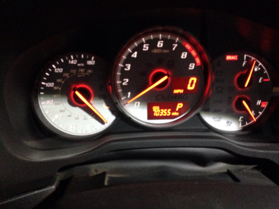

As of yesterday evening. Put the blower on at 34.4K. Still running great.
