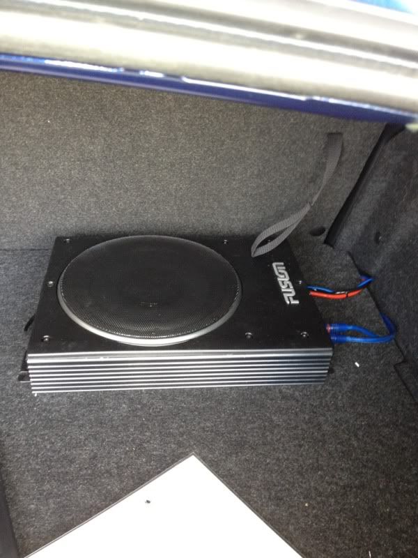

Old 07-30-2012, 01:54 AM   #45
Nate219BRZ
Nate219BRZ's Avatar
Drives: Rip 04 golf gti rip 05 scion TC
Location: NWI
Posts: 230
Thanks: 68
Thanked 65 Times in 25 Posts
i installed this on the passenger side of my BRZ.
Nate219BRZ is offline   Reply With Quote

Old 08-19-2012, 05:23 PM   #47
killercl0wnfish
Drives: fr-s
Location: georgtown ky
Posts: 151
Thanks: 9
Thanked 25 Times in 22 Posts
I've never seen these before ... How do they sound ?
killercl0wnfish is offline   Reply With Quote
Old 08-20-2012, 12:14 AM   #48
Nate219BRZ
Nate219BRZ's Avatar
Location: NWI
Posts: 230
Thanks: 68
i think it adds just enough boom to round out the stock system. I dont want to wake the neighbors stuff. i want something that has good sound with clarity and this delivered that.
