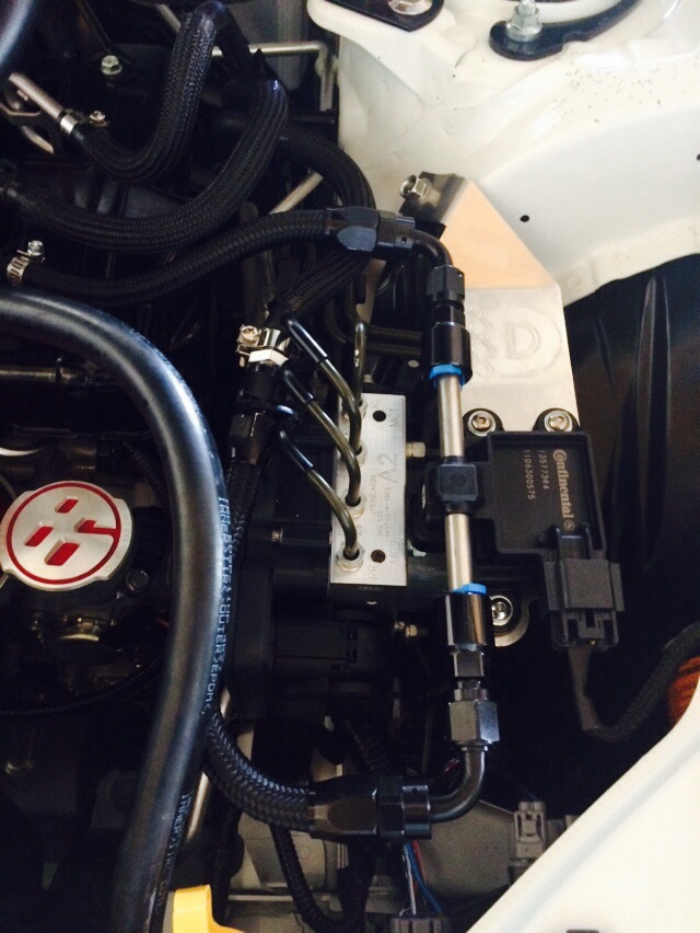

Delicious Flex Fuel installed
Kit took me an hour to install as I went extremely slow, double checking as I went along.
Looks OEM, I like��
Ran some logs on 95 RON for Bill to verify the Flex Fuel tune is good for our conditions, then time to add some Ethanol.
