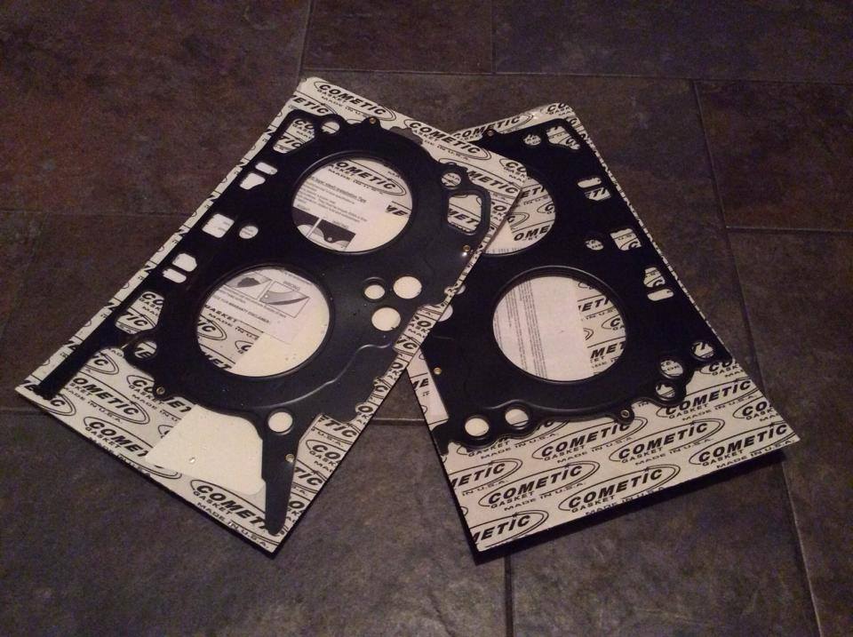

Shipped my block to Darton in California for some a little TLC and these guys showed up 89.5mm
Bad news is I have to find a new crank though
Why the need for a new crank?
