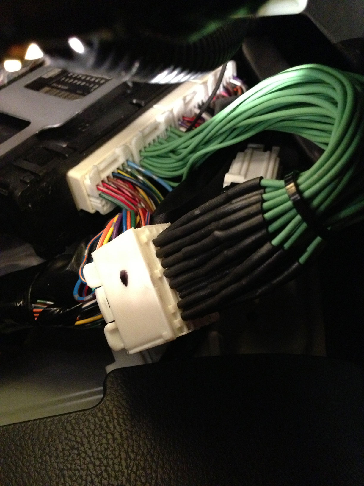

Did I install this correctly? It was surprisingly easy. I didn't remove any panels, glovebox, or disconnect any other plugs. Just stuck my head under there, undid the 3rd plug, connect green harness to ECU, then chassis harness to the green harness.
Also, what parameter do we look for in the logging screen to verify that it's getting the data?
Thanks,
Garland
Yep, looks good to me!

BTW, great write up, @post_break!
Note to everyone: make sure all the fuel line AN fittings are tight, even the ones that appear to be pre-tightened from Visconti. One of mine was hand-tightened and leaked fuel
