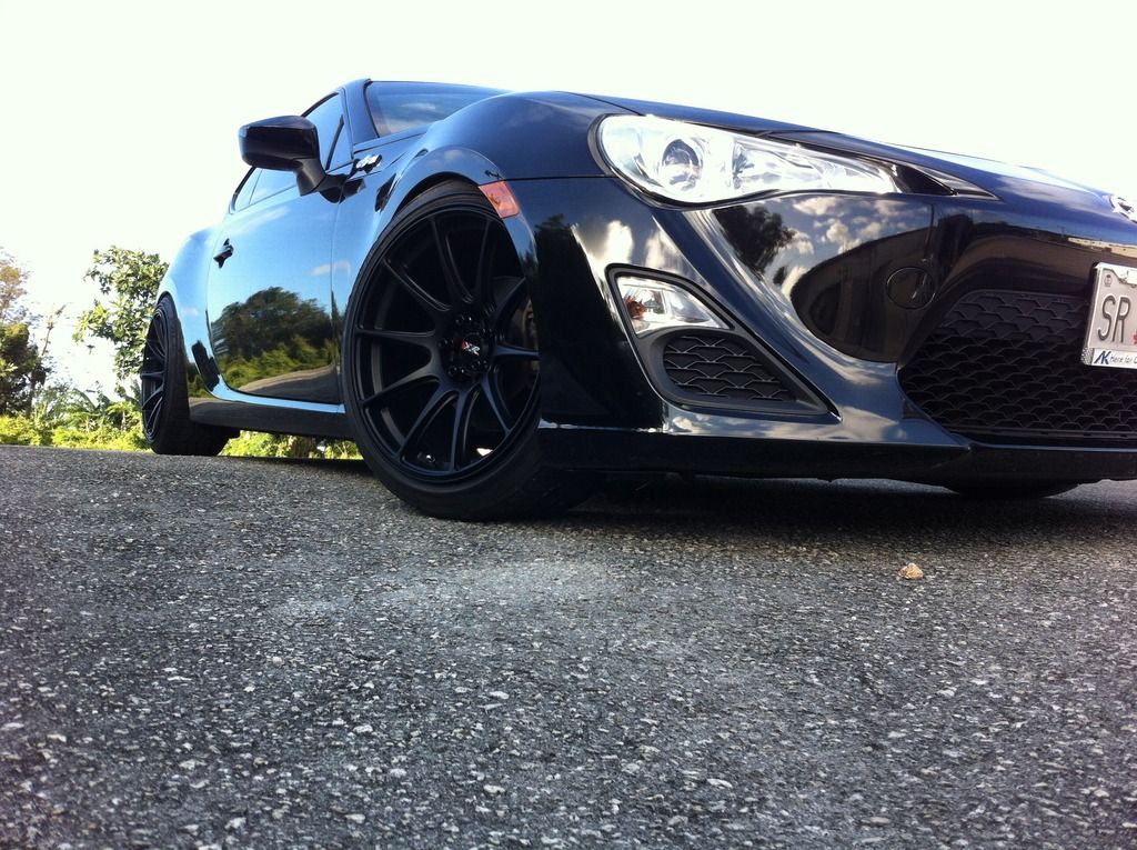

18x9.75 +22 offset , 225/40 falkens , had to roll and grind inner fenders due to hard rubbing in rear . Maxed out camber in front meagen coils . Anyone know how to camber the rear a lil without Lca or tow arm ?
