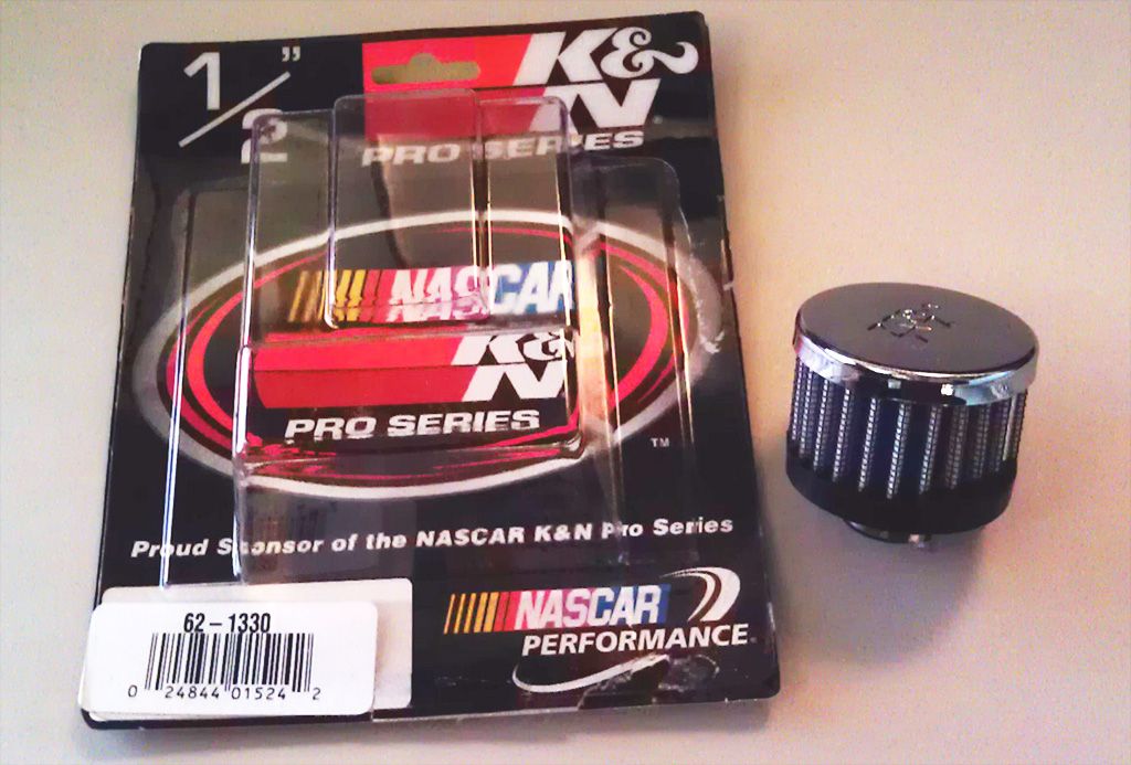

Instead of re-routing oil vapor back into your intake (which isn't ideal for performance), venting it just lets the oil vapor escape out to the atmosphere.
You can just plug a filter like this on the end of that crank case vent hose if you want to vent it out away from the intake..
