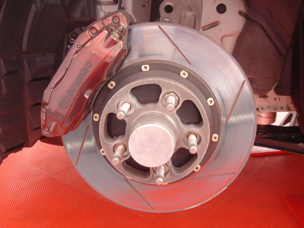

It is difficult to explain but having your wheels bore hub-centric with your car is very important.
Here is an image from one of my old companies race cars. We had to run a spacer on the car, we made an extended hub that matched up perfectly to the center bore of the wheels.
Not exactly a FT86, but wheels and rules of center bore matching wheel hubs is the same.
Image without the wheels:
My old car wearing one of its many Enkei wheels (RPF1) in an Enkei booth:
Some useful wheel info:

Take a look at your two pictures and then look at the stock hub on these cars. On the race car the hub is extended out to go totally through the face of the wheel, on these cars the depth of the flange is like 10-15mm.
On the race car you could probably set the car down without lugs on and have the wheels stay on, on these cars you simply couldn't. The depth of the flange and the offset of the wheels would have the wheel pull off that flange as soon as you put weight on it.
