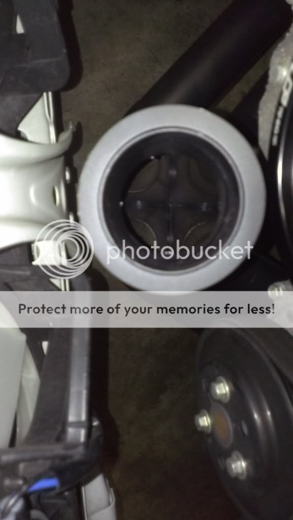

So far so good with the header. I'm happy with the build quality. I have just bolted the header to the heads but have not connected the rest up yet. The fit is perfect where it bolts to the heads. The installation is easy. The 4 outside bolts are just as easy to get to as stock. You just need an extension. The two inside bolts are pretty easy with a swivel extension. I did ground down a small step just inside one of the tubes where it meets the flange that bolts to the head. This was minor but it was there and I grounded it down smooth at a machine shop I used to work at. This was one out of the 4. I did not get pics of it. I'm very happy with the quality of the collector, materials, welds, and coating. Tony does good work. I will be taking my time bolting things up from the front to the back with the Motiv overpipe, HFC front pipe and stock cat back. I'm using new gaskets at each connection since I did have some leaking with the Motiv components. The gaskets they send are not a crush type and may have been the culprit (or installer error). I should have the instalation complete by Friday evening and hope to do some data logging and enjoy the torque curve it should have come with from the factory.

Well its on the car but its very raspy over 3k rpm under any kind of load. Not happy with it at all at this point. I've double and triple checked for leaks and nothing is hitting anywhere. I'm waiting on a new tune and gonna do something about the rasp. I think I'm gonna start with header wrap on the front pipe and maybe add a resonator if neccessary. I may wrap the header but I'd rather not. Thought about putting the muffler at the rear of the stock front pipe on the Motiv overpipe as well. Any tips are appreciated.
Thanks!
EDIT: noise I had labeled as raspiness was most likely the overpipe hitting the subframe. This issue has been adjusted out.

I am now very pleased with the FA20club EL 4-1 header. I purchased it catted and coated. I wrapped the primaries up to the collector with Thermo Tec header wrap, painted it with Thermo Tec paint and reinstalled. I also received and loaded a new map from Tony. I am 100% pleased now with the header, performance, and sound. No more rasp! just clean smooth aggressive sound with no drawbacks. I still have another map coming and may try to do one more since I'm probably done with performance mods for a bit. No more torque dip. This car runs, sounds, and feels like it should have from the factory. Tuning is where its at to make these mods work for sure. Again, overpipe is Motiv coated, front pipe is Motiv catted. Catback is stock. Here's a video pulling out through 3rd gear shifting easy.
