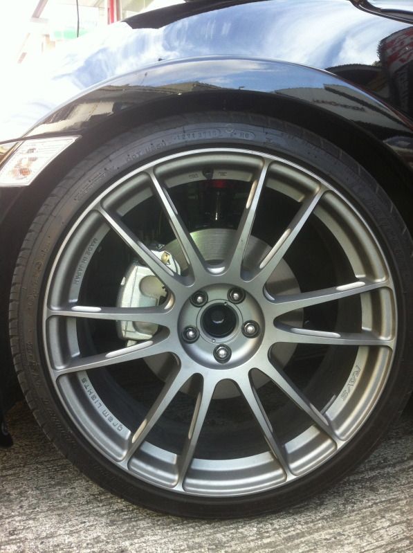

Car look's great! Loving the wheels.

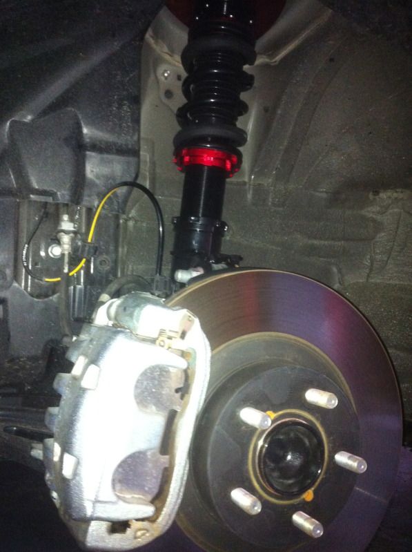

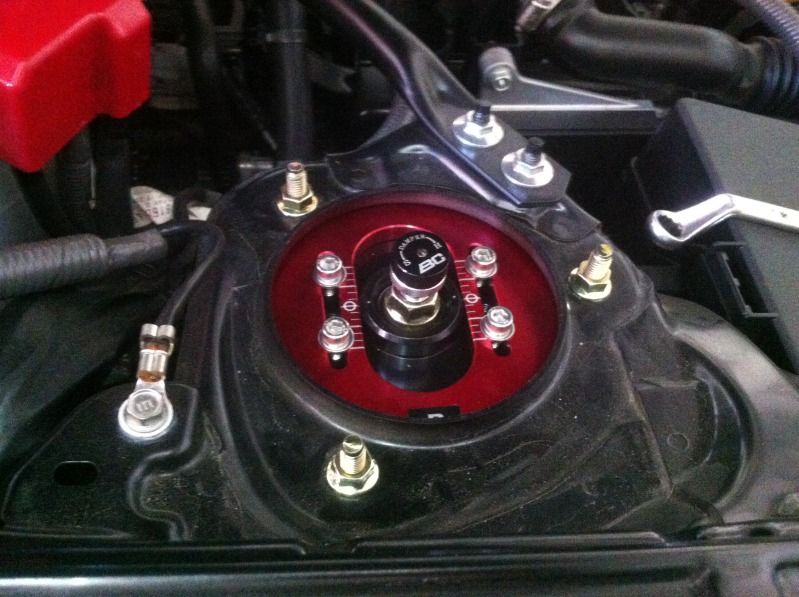

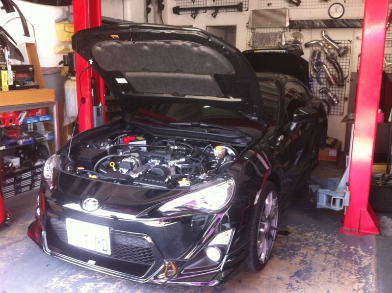

Originally Posted by Tye300 View Post
My coilovers arrived the other day after close to a months wait.
Here are some pics of the hardware:
Some pics of the install:
Some before and after pics:
Stock ride height(front):
After:
Stock ride height(rear):
After:
Before:
After:

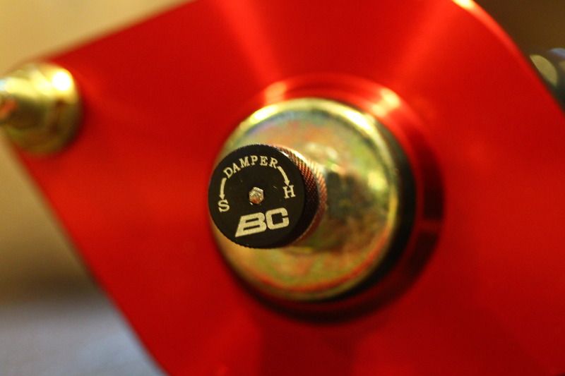

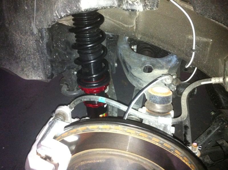

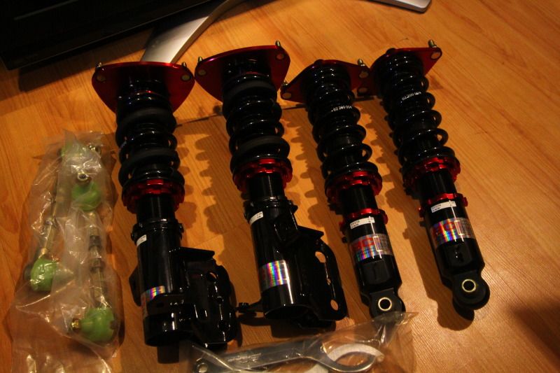

Ei man! Are these bc racing coils? V1? Different to br coils that is available here in the US?
tintumz22 is offline   Reply With Quote
Old 11-17-2012, 01:43 AM   #45
Tye300
Tye300's Avatar
Drives: Toyota 86 TRD Version AT
Location: Manila, Philippines
Posts: 883
Thanks: 548
Thanked 599 Times in 283 Posts
Hey bro! If you look at the BC Racing UK website, here's the specs.
It is different from the BRs.
http://www.bc-racing.co.uk/coilovers/

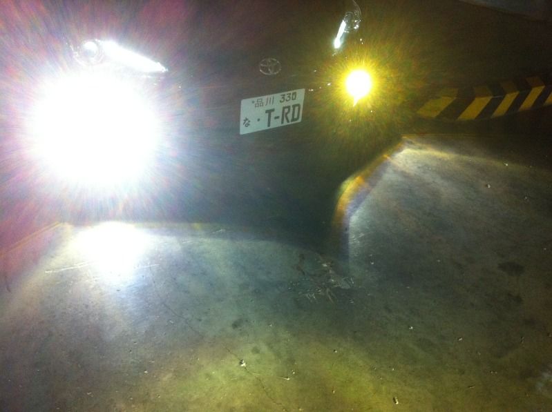

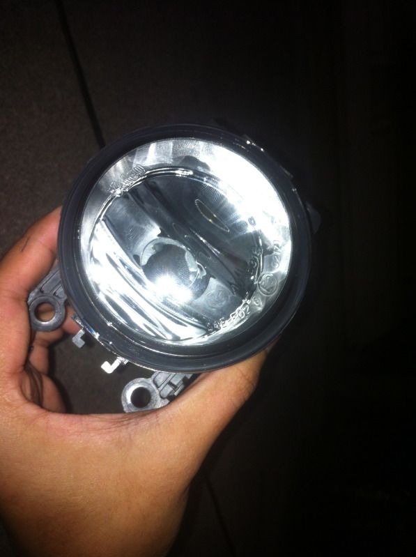

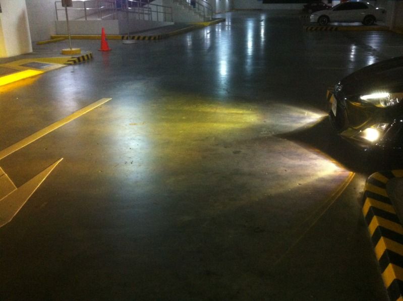

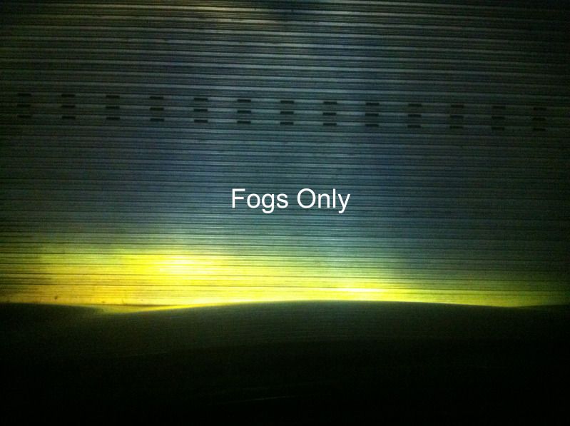

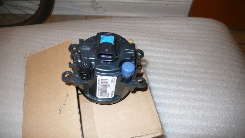

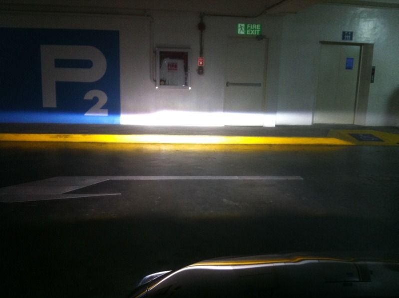

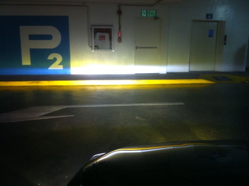

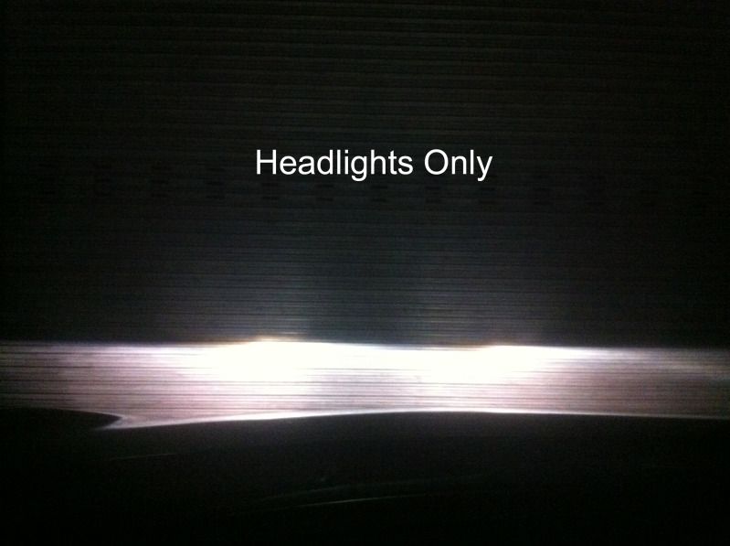

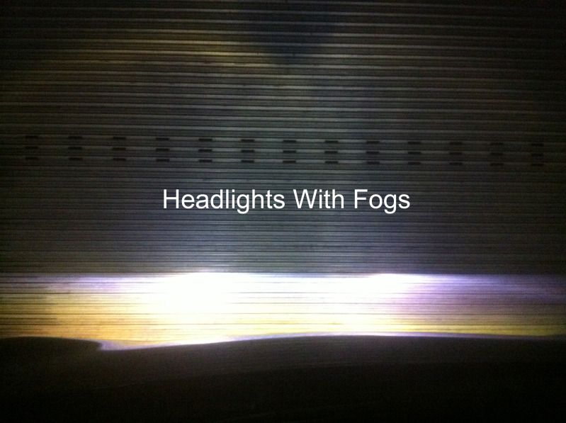

I ordered subaru outback foglight housings which takes H11 bulbs. These housings will take more heat compared to the stock flimsy ones. The lenses on these housings are beefier and I don't really know why they made the stock ones while the subaru ones pretty much bolt on. Weight savings perhaps. The housings arrived the other day and I got around to installing the H11 fogs into it.
The housings need a little modification to bolt on. You need to trim these little hangers so it will clear the metal mount we have on the 86.
Everything pretty much bolts on, took me around 10 mins to bolt everything up. Since I put the H11 HID bulb in the stock housing, the light output was not as focused because the housing was not designed for an H11 bulb. With the outback ones, which are designed for the H11 bulb the output is really good and focused. Here are some light output pics:
Ground cutoff:
Stock Housing with HID: (for comparison)
Light Output Fogs only: (beam is more focused and solid)
Headlight Only:
Headlight and Fogs:
Output against a wall:

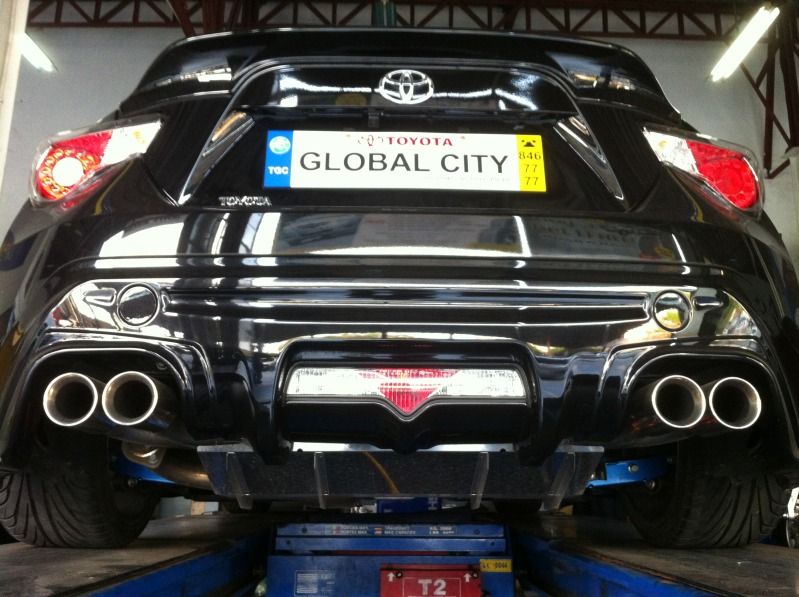

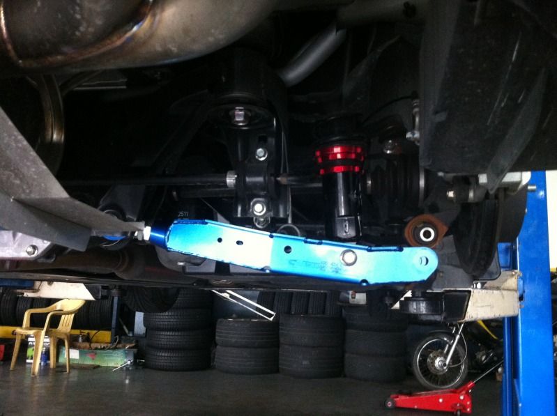

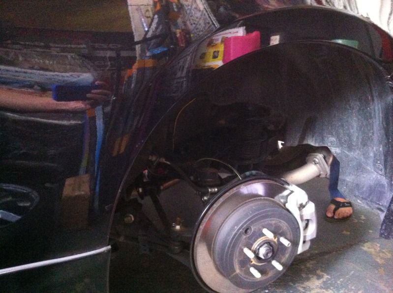

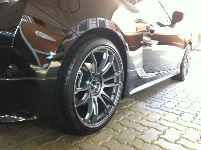

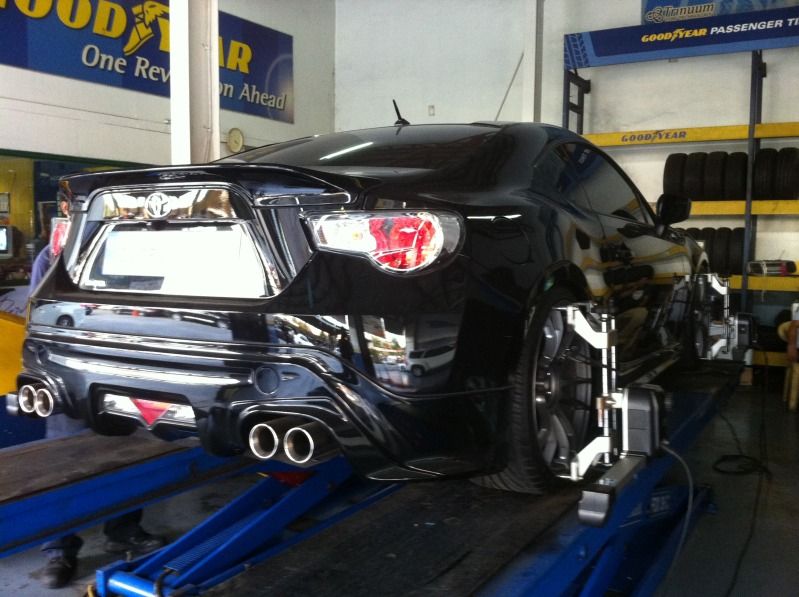

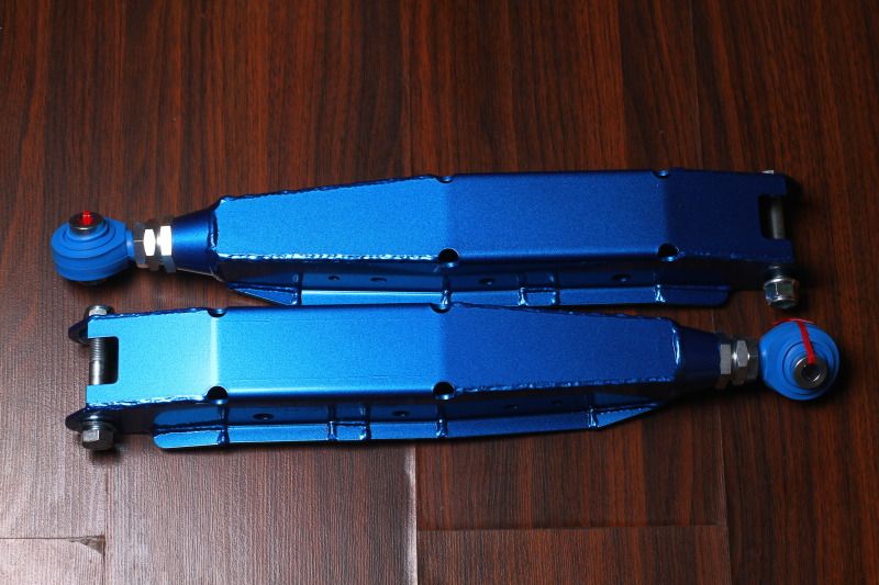

Installed LCAs and wheel alignment done!
Got the lower control arms this week and had them installed at the local alignment shop. Been waiting on this part so I could correct the rear camber on my car since I did a sizable drop with the coilovers.
Installing the arms:
Installed:
Alignment:
Before and after specs:
Some glamor shots:
How the tires sit after alignment:
Any suggestions on the specs? 2deg of negative camber still too much for DD? I wanted less negative camber, but the shop mechanic told me he was worried that the tires might rub the fenders. Is that possible? TIA!
