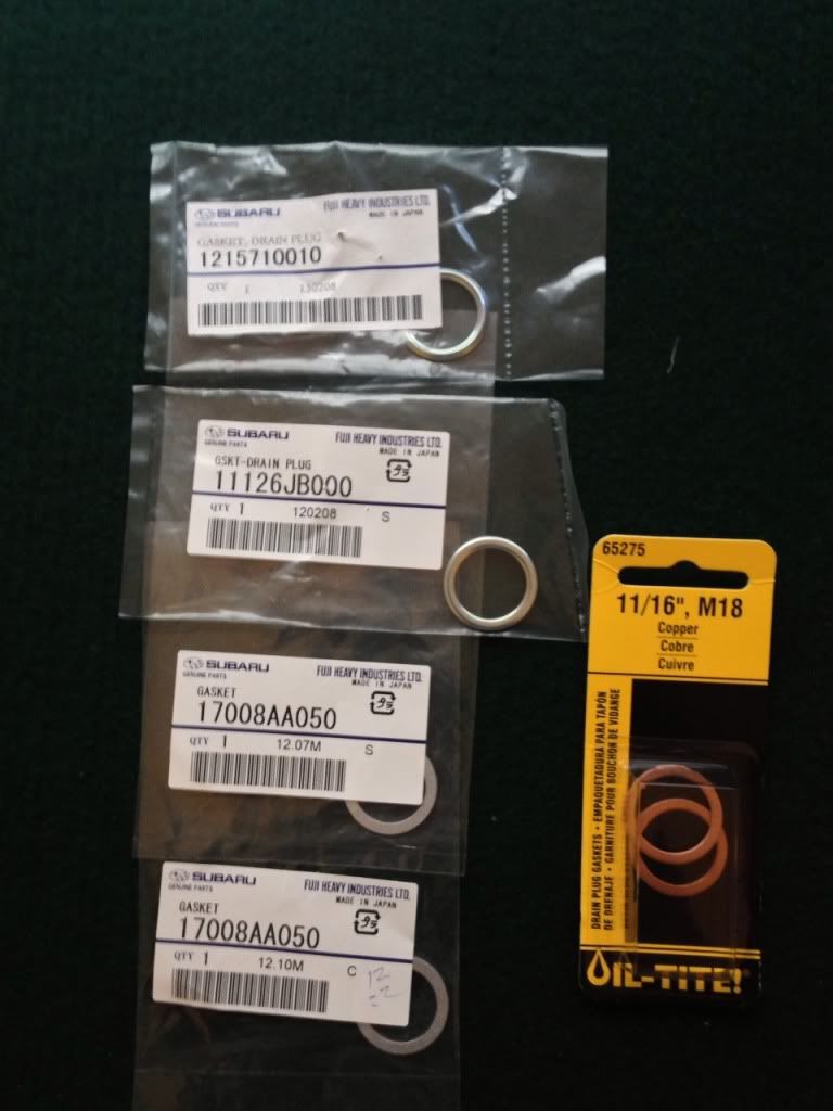

maybe OP can go ahead and post up these parts numbers for the crush gaskets in the original post -- can someone who's done this confirm these are the right part numbers?
Differential fill plug gasket: SU00300122 @$2.30 each
Differential drain plug gasket: TOY1215710010 @$1.50 each
Transmission fill/drain plug gasket: SU00303626 @>$11 each
I went to the Subaru dealer today and he said the Tranny fill/drain gaskets are $8 each so I ordered those, but he did not find any parts for the differential. If someone can confirm these are the right #s I will call him back and ask him to order these for me too. Will the TOY # work at Subaru?

okay so i just changed my diff and tranny oil but did not replace the exisiting crush washers with new ones.. It's Sunday today and the dealerships are closed so i have yo wait till tomorrow! Is it imperative that i replace them with new ones?
I picked up the parts (which were special order) at my local dealer and when I got them from the parts guy, he was pretty skeptical that these parts would need replacing... he confirmed what others have said that these oem gaskets/washers are aluminum and don't crush very much. He suggested that in the future (since I had already bought these), to just reuse the existing gaskets, or get copper ones from a local parts store for far cheaper. He said copper gaskets would crush/deform better and make a better seal. I did find a pair of gaskets at O'Reilly's Auto Parts that seem to be the right fit and would work just as well. Anyways here is a photo with all the parts numbers from Subaru.
Agree. The tranny washers did not have any noticeable crush to them. The diff washers did crush significantly tho like the oil drain washer. I suggest just replacing the diff washers (2) to save a couple bucks.
thats becuause they are not crush washers , the transmission does not have any.
