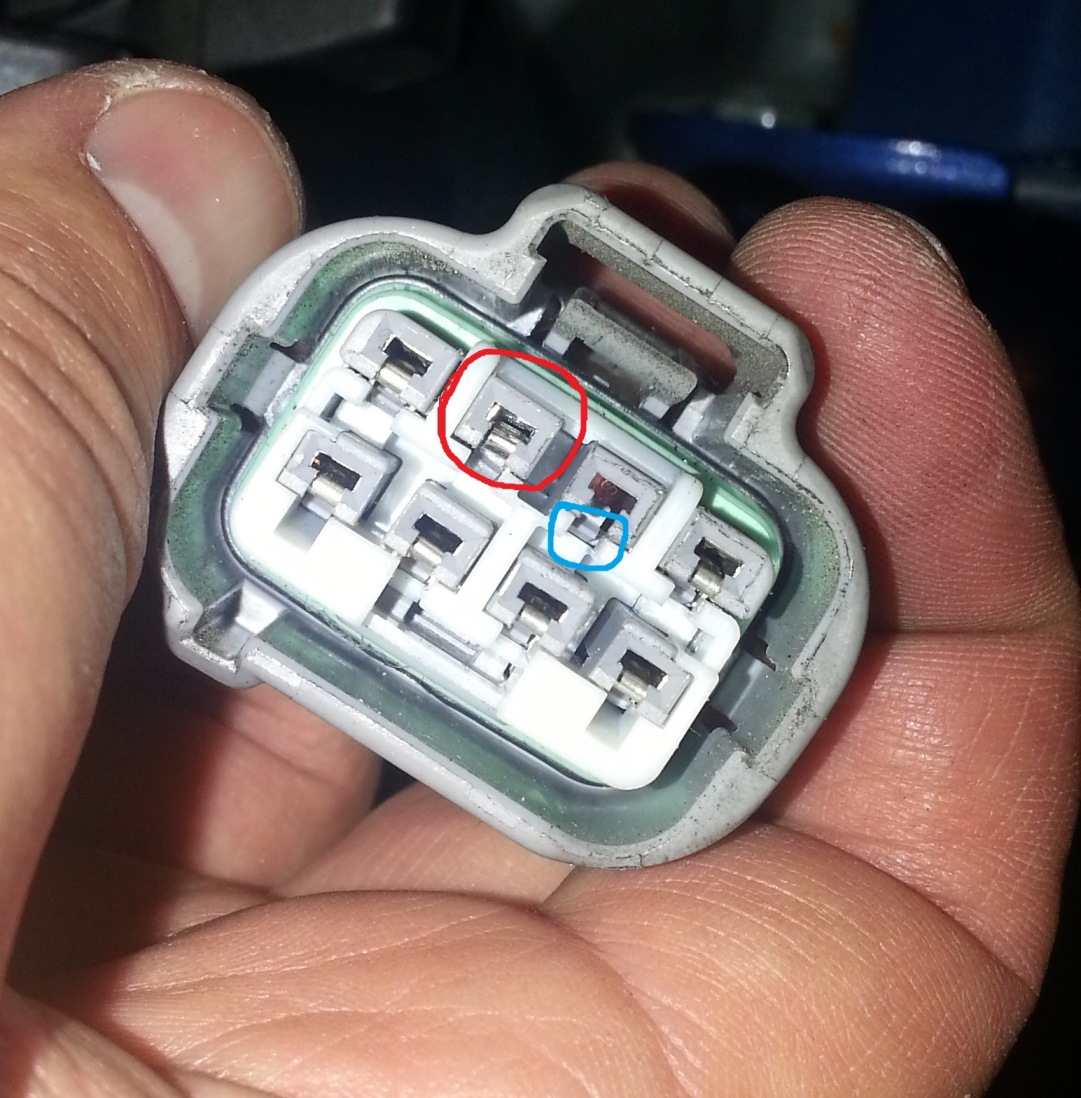

^Not the best of pics. This seems to be a pass-side plug. So, per wiring diagram, one should route the power to the terminal #2, white wire. Which is one the back row of the pic, second from the bottom. Red wire with a brown insulator right on the 'knob' of the plug is terminal #5, #1 is right behind it, and #2 is one up. On the other side the wire colors are different and you'd have to splice into a red wire, still on terminal #2 though.
Personally, I'd just route a wire from some ignition switched source directly (or rather via a relay just to be safe) to the halos and not mess with soldering. Just disconnect the OEM wire off the headlight harness and plug your ignition-sourced one.

Okay, I did it the way @Respect BRZ has it.
I'm not entirely happy, so I might be re-doing it. That's when I'd do a write-up.
A few notes:
1) Currently, I did grab ignition-switched power from a IG2 fuse under the hood (see pic). I'm not entirely happy with that (lots of useful stuff on that fuse), I'm probably gonna re-do it with a relay, still using ig2 source to close the relay, but take power off some empty fuse slot.
2) I have a thing for preserving factory wiring. So I've spent most of my time trying to take pin #2 off factory harness and sourcing a replacement pin that would work in its place. I went to my local autoparts store and grabbed the only thing that looked remotely similar. It ended up being okay. The pin in that replacement harness is a bit narrower than OEM one and the rubber seal is too small, so I had to make sure to wrap something around that pin before plugging it into the OEM harness.
3) Now, taking the #2 pin (red circle) of OEM harness is basically my only useful contribution. The white part of the plug just pops off with a bit of effort. Then one needs to pop up the latch on the pin (blue circle) and push the pin out of the plug. The mechanism is the same as in the parts-store plug, so take the pin off that plug first to practice.
