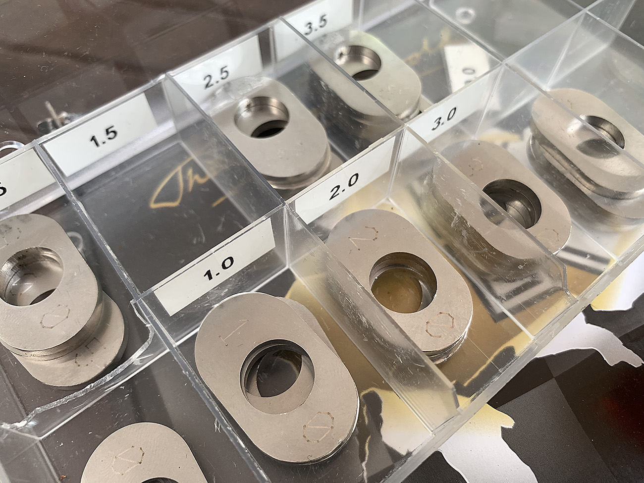

Old 04-02-2020, 09:40 AM   #55
grumpysnapper
grumpysnapper's Avatar
Join Date: Jan 2020
Location: Brisbane, Australia
Posts: 352
Thanks: 309
Thanked 608 Times in 209 Posts
I promise this is my last self indulgent picture post of my latest fixation!
A lovely little box was part of the shipment, packed with the camber 'bushings', (all laser engraved with their settings), and the little rebound/compression adjustment tools.
The other thing that caught my eye was the lovely custom lower rear mounts, and their O ring seals.
Lyndon
grumpysnapper is offline   Reply With Quote
