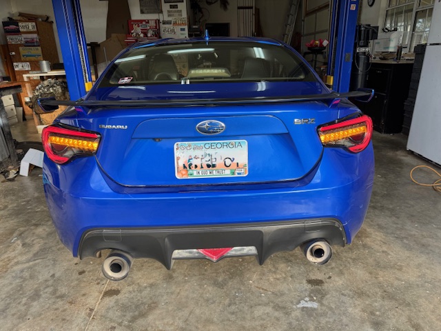

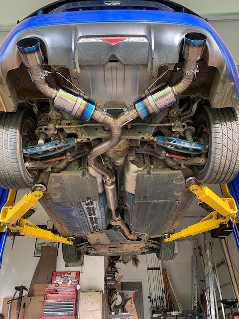

Nice pic of the Tomei titanium cat back (prior to mid pipe upgrade)

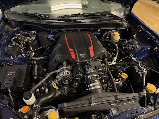

Well, my car has come a long way in the past 5 years. Today I finished the planned engine mods by installing:
Deatschwerks 340 pump
Deatschwerks 700cc injectors
Delicious V3 Flex fuel kit with bluetooth fuel pressure monitor
Delicious Flex fuel Edelbrock SC tune.
Test drive revealed leaking fuel tank gasket. Will attempt to reinstall in the morning. Very long day and time for a sippin beverage.

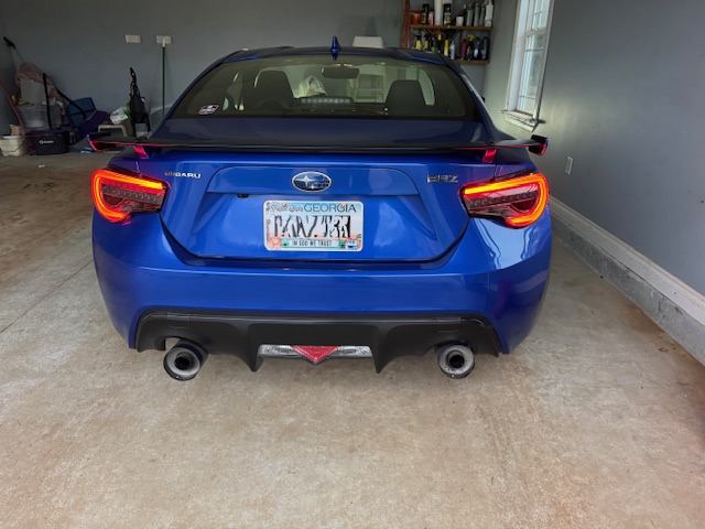

Just a little update. Just serviced with 132k miles on the clock, over 70k now on the supercharger. Sent an oil sample to Speediagnostix to see if they have any lubrication improvement recommendations. Had a minor boo boo in the driveway which resulted in a damaged tail light. Seemed like a good time to try out the look of smoked sequential tails. Got the Delicious air/oil separator installed. Calculated about $50 a year in additional fuel cost running E85 (Racetrack pump), small price to pay for such a power adder.

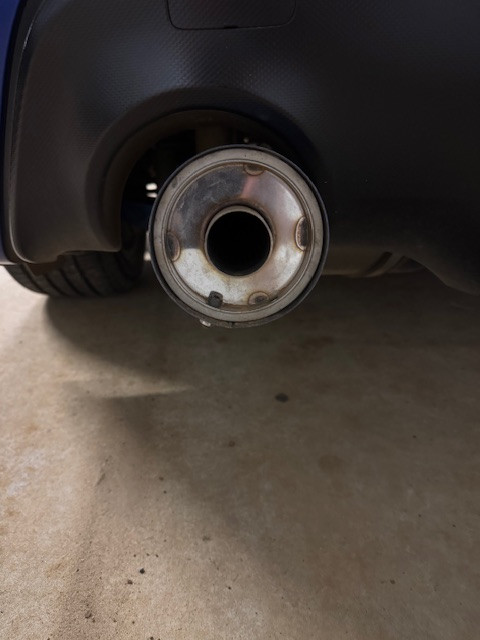

After being scolded by the SCCA for being too loud (couldn't agree more) I ordered a pair of Skunk2 silencers that looked like they would fit. They didn't. I had a local machine shop waterjet a pair of bushing out of 304ss, which I welded to the silencer flanges. Works great, sounds great, I can once again hear the stereo!

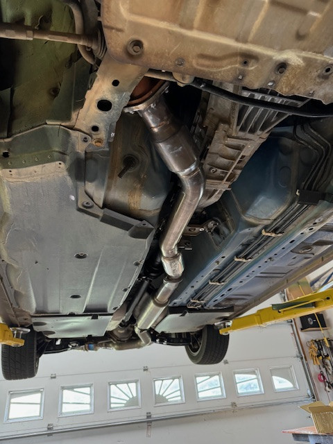

Well, a lot has happened in the past month. Took time off and met my brother in West Virginia to Touge around the mountains with his new ZL1 convertible 6 speed. By the time I had negotiated an unscheduled meeting with a GSP Trooper and apocalyptic thunderstorms (the one that washed out I40 again), my car was running like trash when I got to the hotel. replaced O2 sensor and cleaned MAS, but no avail. Cut the trip short and limped home in defeat. Got home and found cylinder 3 primary tube 3/4 broken. TIGged up crak, still running crap. Felt around the expansion joints and voila, found a massive leak just upstream of the O2 sensor. Cut the braid away to find the corrugated stainless fatigued and crumbling after about 105k miles. Located a Skunk 2 EL header about 4 hours away and spent my Saturday making that trip in the Outback XT. Turned out a great trip, seller was cool guy who had a super clean modded 18PP. Anywho, made it back, installed and hallelujah my car is running great once again!
