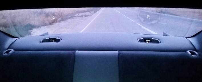

I removed my 3rd brake light entirely after I failed to stop the rattling with complete disassembling and adding silicone sealant every friggin part. I reupholstered the deck with foam and vinyl to go over all the holes and to match the car. It looks great. The annoying rattle is reduced 70%, but oddly enough the soft vinyl gives a low grade rattle against the glass now with certain bass notes. I am going to add a small black weather strip between the two and see what happens. These trunk rattles are insane to get rid of completely.

I have the Mustang high mount light that has been mentioned in other posts on the way (being delivered tomorrow) . I actually left the holes unplugged, and put two 3" holes in the stock deck so I could get more sound through from the trunk. I can notice a difference in the sound. I just used a hot glue gun to secure the new fabric. I also left the car seat latches as I have a baby about due, otherwise I would have covered them.
