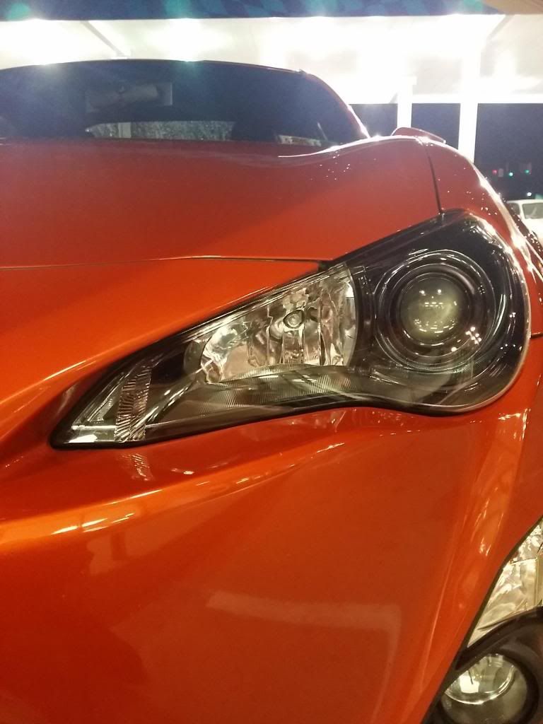

Thanks homie. So that yellow just goes right over the reflector huh? Should I even use painters tape? Because doesn't it just go behind the housing anyways? Btw your headlights look sickkk... @ck-GT86

Hmm...I suppose you could, I forgot the reason why I masked it off. Might have been because I wasn't sure how much the housing covered up the chrome parts. Clean up the reflector real good, use some mild soap, and make sure you don't sand it. The spray might foam up a bit, leave it in the sun and it'll go away. And it's important you apply that with light coats only. It wasn't until several, several light coats when I sprayed a little heavier.
Thanks for the compliments!

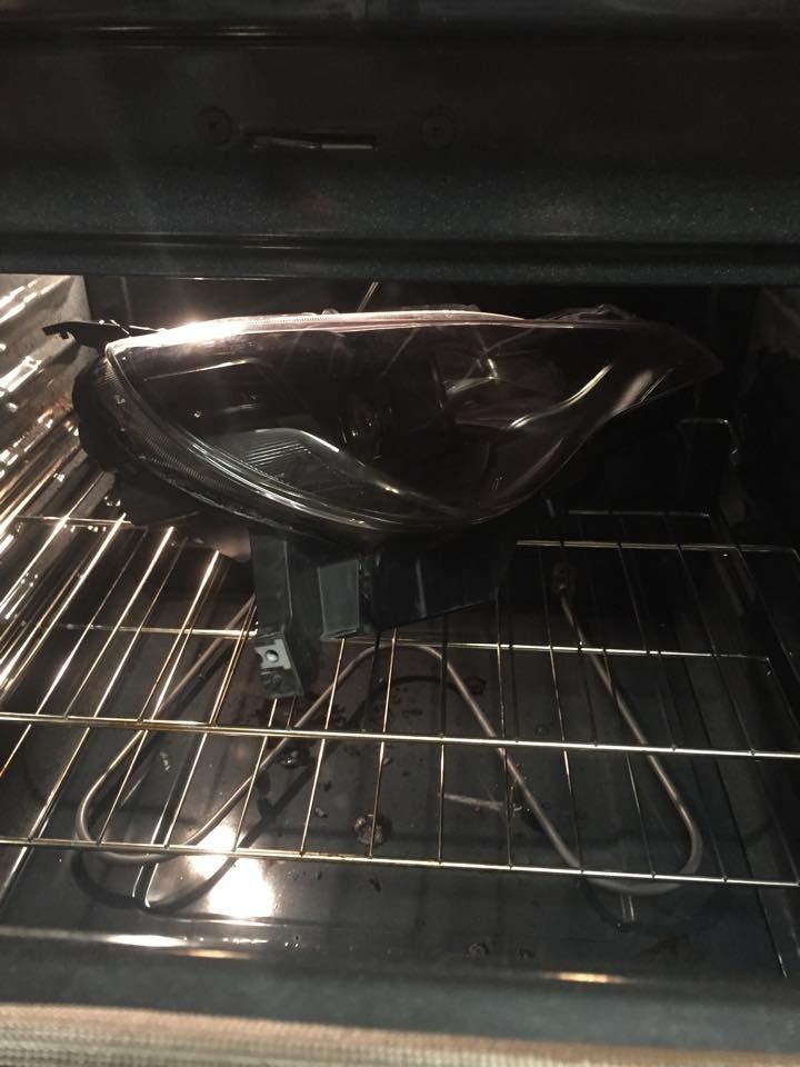

Here's mine during. I also added RGB demon eyes.
