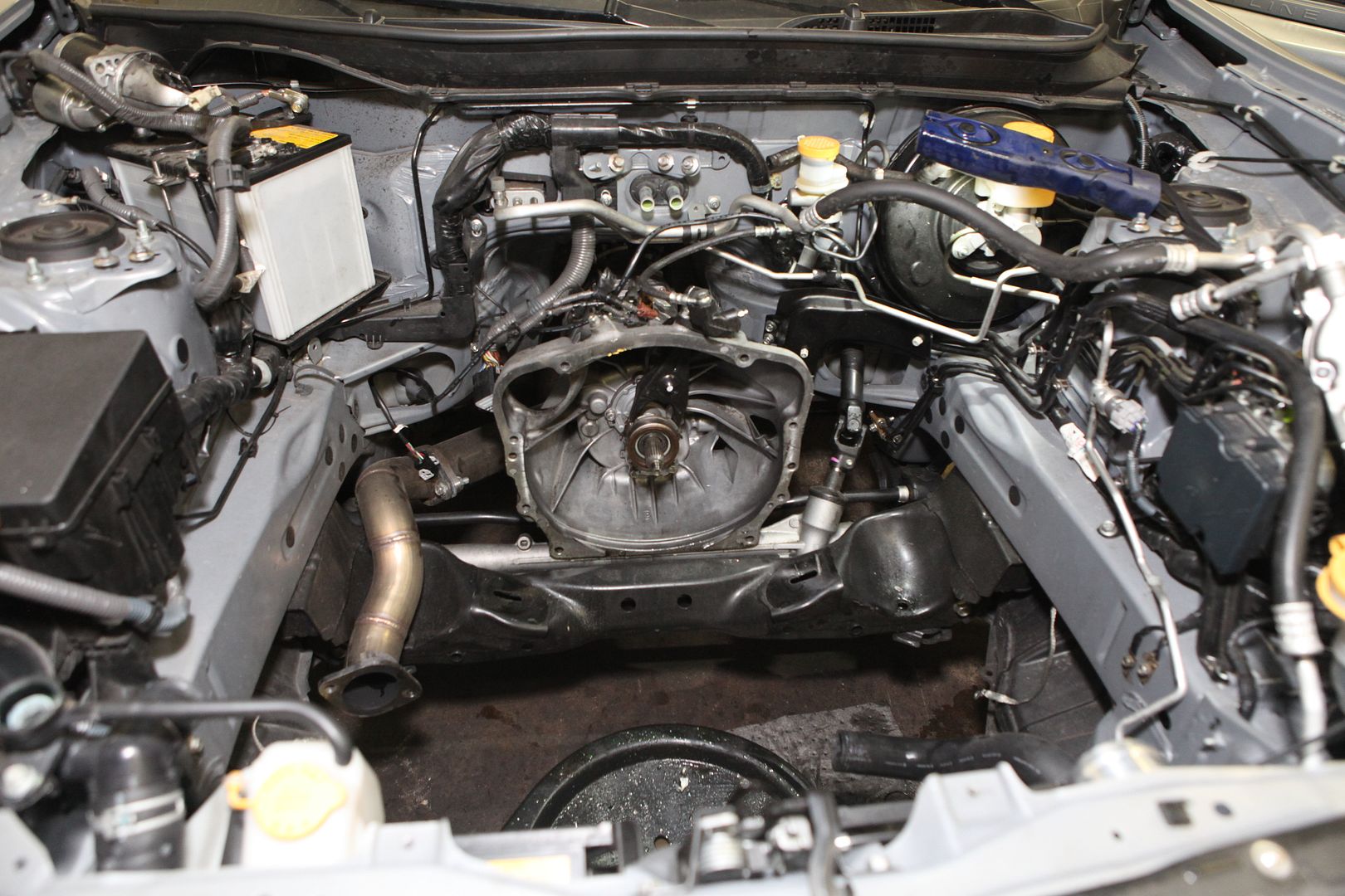

Taking more pics of other things now but this is a start.
Car is supposed to have 8 bolts and 2 nuts holding the trans to the block and starter to the trans and there was only 3 bolts holding the trans, 1 bolt holding the starter and one nut. The two other bolts are from each motor mount. One took a few veins to get off since it was the wrong size.
Look on the left, you see the one stud, the other stud and bolt are missing on the right hand side.
Third bolt missing

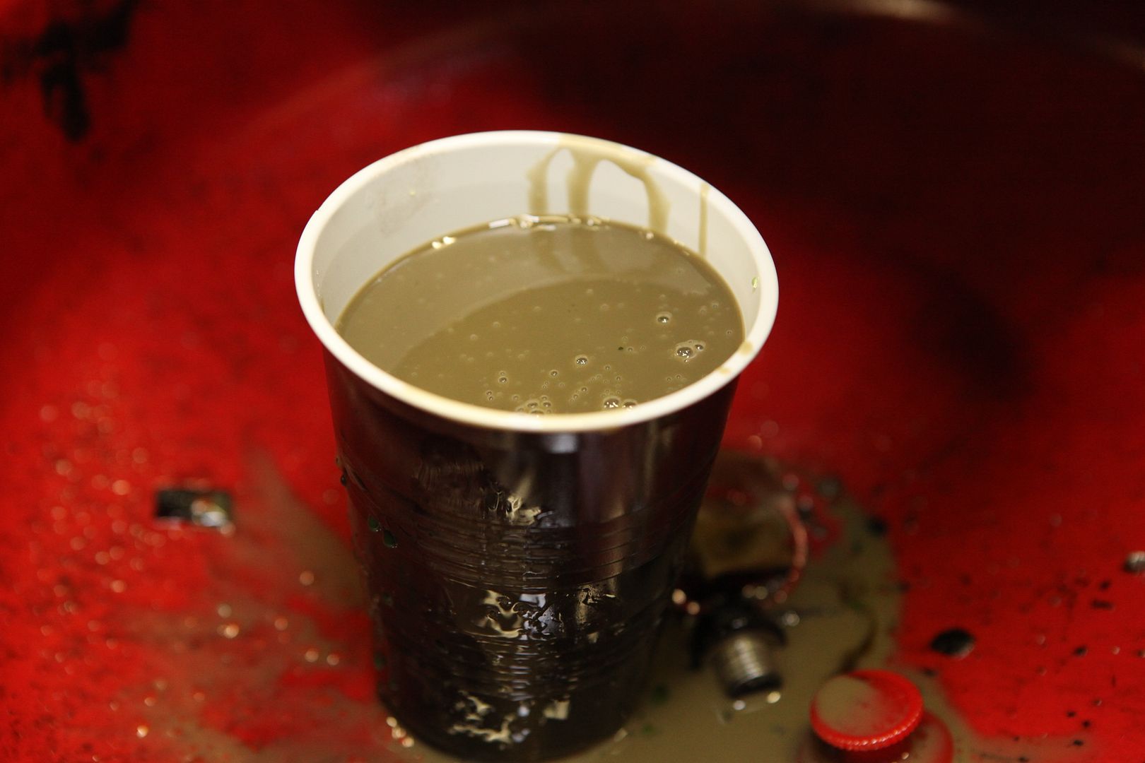

Milkshake
Motor is being disassembled and we will be assessing internal damage next.
