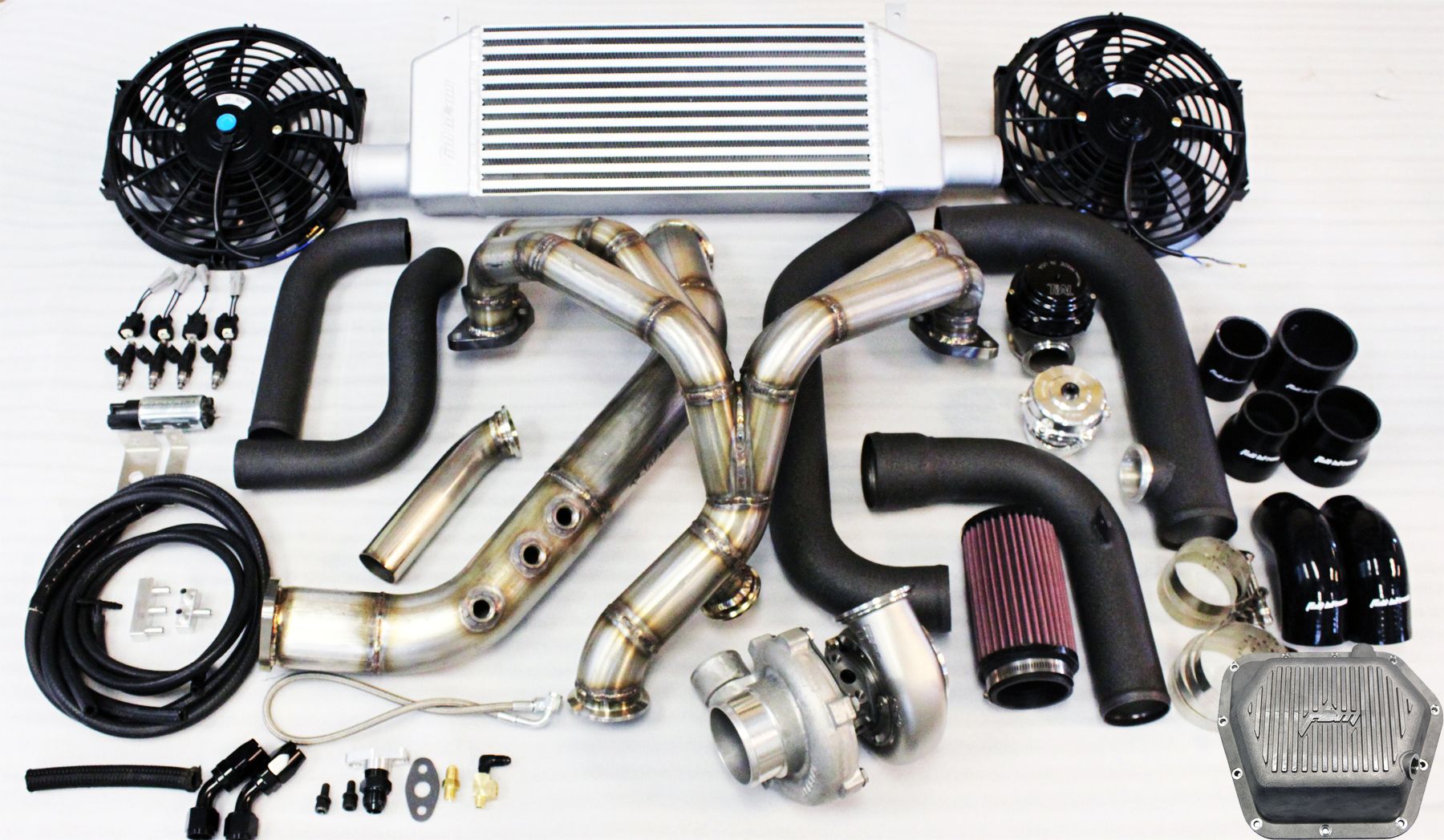

If i were to get the base kit for about 4,000 with the t3 50 trim would it be plug and play or is there some modification required also what is the power like with the 50 trim

Our kit comes complete with injectors, pumps ect. You will need a ecutek license to flash the map.

The base doesn't have the tapped oil pan listed either, is that correct?
Differences between base and premium as far as I can tell is:
-V banded dump tube vs non v band
-No tapped oil pan
-No gt28 (still an option in the base kit)
-Precision 39mm wg vs tial 44mm wg
Is that all correct?

Thicker schedule 10 manifold, I think it's a v band manifold and downpipe too. Hand made intercooler that's tons lighter.

Random install question if anyone knows specs off hand.. I have the FBM oil cooler and radiator going in as well. with the stock oil pan in do I need to add any extra oil to compensate for the turbo and oil cooler? The stock requirement is 5.8 quarts I believe. Also, coolant capacity with new radiator?

Yes and yes. Use your dipstick for the first and keep filling the radiator till it comes back out at you.

Will this work with the perrin intake?

FBM kit, comes with an intake.

I know, i was just wondering since i have a perrin intake if it would fit.

It won't fit.
