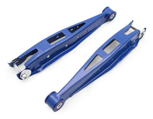

Hey, reviving this thread cause I was wondering if SPC and Whiteline ones are really the same as you state here. Whiteline weights 3.8lbs while SPC is 4.5lbs, according to official sources, so what are we missing here hmm
I will be buying some reasonably priced LCAs and WL is my main option, due to weight factor

I've had both WL and SPC and they both have "SPC" stamped on them so they are indeed the same. This is also the case for the SuperPro arms.
Only difference will be the inner bushings, which will be polyurethane in the case of WL and SP, but SPC uses a "cross-axis" bushing that seems to be similar to the pillow bushing found in the OEM STi RLCAs. Weight difference between the bushing styles will be negligible. I believe that Whiteline originally had an offset in their inner bushings but their newest design has removed that.
Either way, all these "SPC" arms seem to be non-OEM replacement arms that are slotted by SPC. I believe some of these companies have procured and painted them for re-sale.

very good info thanks, actually SPC answered to my email:
Code:
Once upon a time we did, though I hear we haven’t sold any to them in quite a while. Not to say that they didn’t just do a big one time buy and not need anymore though, picture on their website sure has an SPC stamp on the arm.
There’s few contributing factors to a weight difference- 1) Whiteline running a urethane bushing vs our xAxis, and the xAxis is generally a little heavier due to construction , 2) our weight includes the weight of the toe bushing we include in the kit  and it doesn’t look like theirs comes with such a critter, and 3) our weight is a packaged weight and I don’t know that theirs is. And if you’re being SCCA Miata levels of pedantic ours have a black finish coat on them, but that’s a special kind of scale that’d even register that.
so yep we can confirm in nearly the same. Thereby I will go for the SPC due to the xAxis

IMO LCAs are overprescribed and generally not needed. Also nowhere near the level of engineering and testing (including millions and millions of miles of real-world street and track testing by we the customers) behind them vs. OEM. For probably 95% of these cars that are tracked, aftermarket LCAs are not much if any benefit and will almost certainly have a much shorter lifetime than stock.
I'm a structures engineer and IMO almost all aftermarket suspension offerings are a but suspect... When I needed to lengthen the lower front control arms on my 240Z I modified the factory arms myself rather than entrust my safety to adjustable aftermarket arms...

I went with Whiteline rear LCAs to get some adjustability. With my car lowered 1", the stock LCAs gave me around -3* camber and with the toe at 0" I was getting a lot of wear on the inside of my rear tires(17x9). My camber now is just under -2*. I would have like to have gotten it closer to -1* but I would need aftermarket toe arms.
The Whiteline quality looks pretty good. Nice powercoating. I probably need to invest in a pyrometer to check alignment rather than waiting for the tire to wear enough to see what is going on.

Huh, I've never had undue "camber wear" running -3.2 front -2.8 rear camber since 2018, even on winter tires that never saw track or even "spirited" street use...
Aftermarket can look great, have perfect welds, but they just aren't going to be backed up by anything like the analysis and testing vs. factory arms.
I don't use a pyrometer any more as I simply won't have enough dedicated test time to determine what temp profile is optimal for a given track. Fortunately there is a quite broad range of camber settings that will work quite well, particularly at the rear. Front definitely wants on the order of -3 min...
