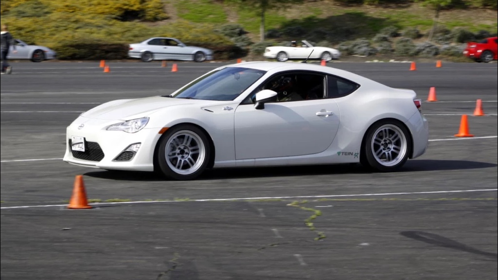

i have the street flex. Did more street driving than track so comfort for the wife was priority. Besides my driving skills are so low that I couldn't use either's full potential. Much better valving choices than the flex on my miata and twin tube is pretty tried and tested. EDFC active makes it a breeze to adjust when its time for track and the GPS auto tuning is pretty awesome for the togue. Less bumpy than the monoport overall but they are more performance oriented and use newer technology. If they made a mono-comfort i'd probably would've gotten that. I just like the fact that TEIN products are still made in japan although the steel tophats are kindof a letdown. Someday this car will be a track toy and i can put the spine crushing SRCs on lol.

Awesome thanks man! How much of a drop does the Street Flex offer?

I initially slammed it to the max drop at -2" but I scraped everywhere and decided I wasn't about that life anymore lol. I'm now at the recommended drop at their website -1.26 and -1.3 at the rear. Name:  ImageUploadedByTapatalk1416327384.936573.jpg
