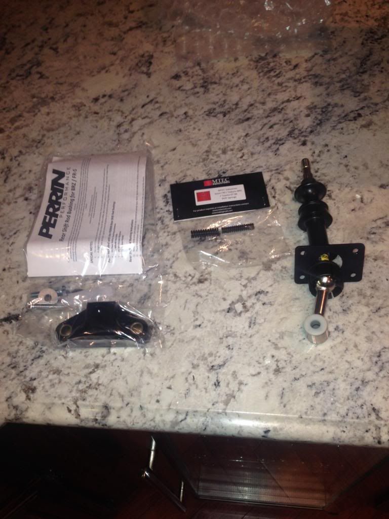

Got some new goodies in the mail.
Kartboy Short Shifter
Mtec Shifter Springs
Perrin Rear Shifter Bushing
