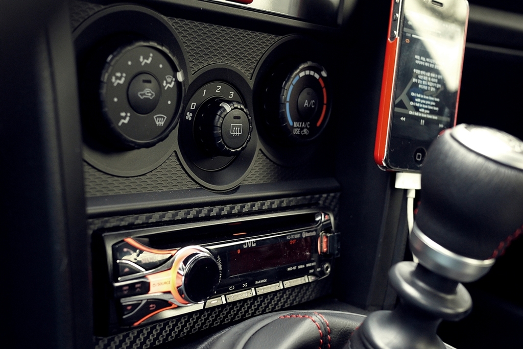

Do you happen to have some more photo's of the single din installation. What exactly did you cut and how you did the facia?
Cheers,
Sam
Sorry, I didn't take any picture inside during installation .
There are two point blocking inside. left one is easy one but right one is thick & hard to remove .
That fascia adaptor is just thick paper of desk calendar.
I cut the paper & attach 3M carbon sheet to it. It looks cooler than I thought . =)
