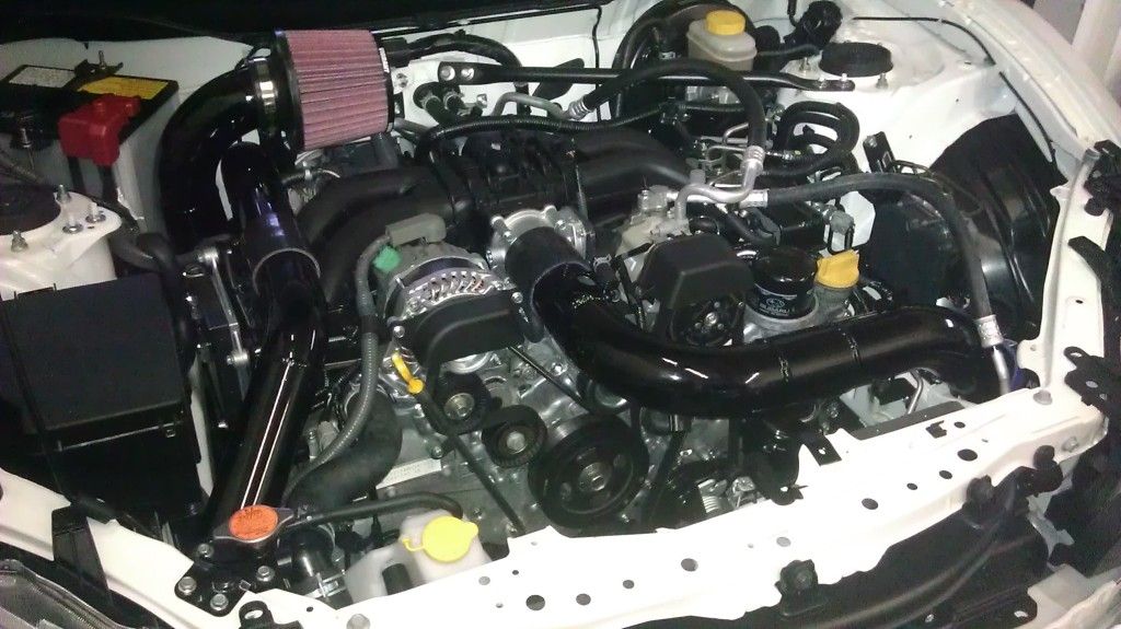

Here is the fresh look of the powder coated pipes. You will be able to choose from a variety of colors for no additional charge when ordering a kit.

Thanks: 245
Thanked 111 Times in 79 Posts
Powder coat looks great!!
