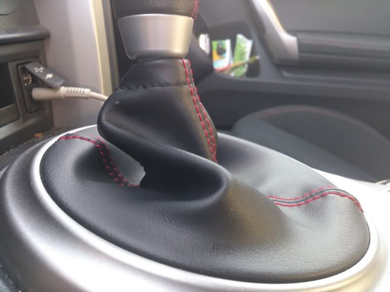

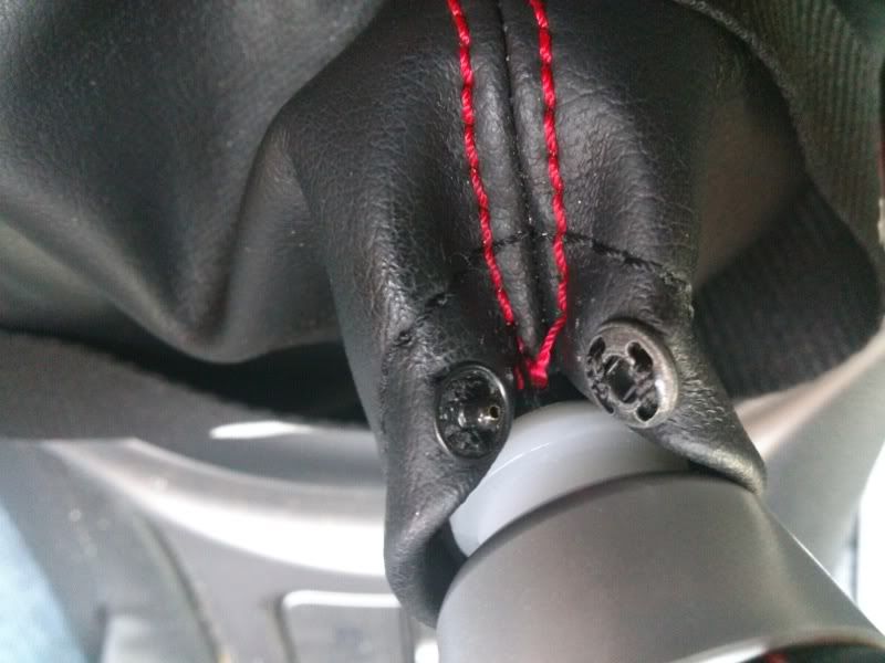

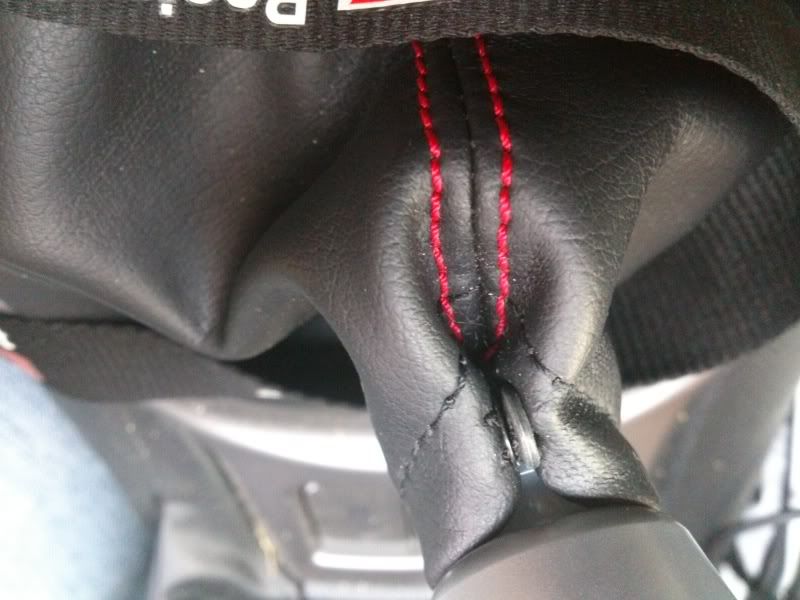

Sorry for the upside down pics. Lol they are taken in between the center console and the shifter so it was hard to get a good angle. That is the snap button put in place since the collar is much larger on the my compared to the at.
So all we need to do is get the MT boot and mod the PRND screw holes?

And put the snap button on the collar of the boot to get that to fit. But otherwise yep, that's it.
