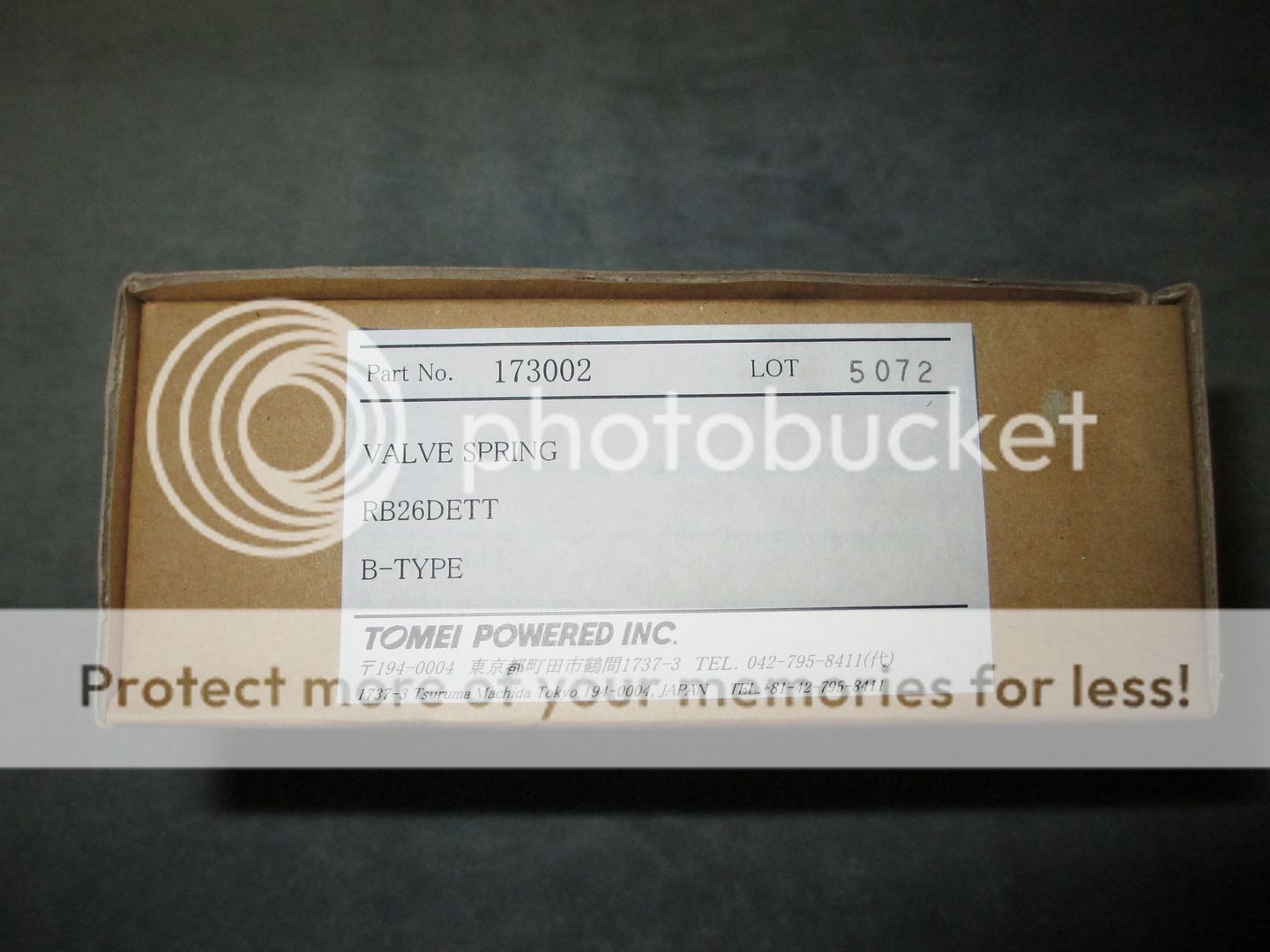

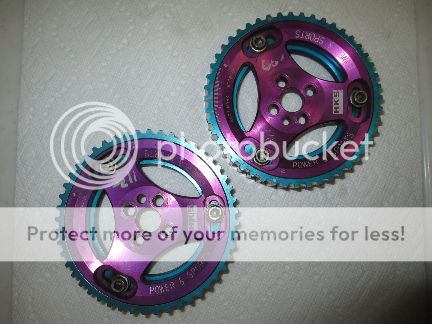

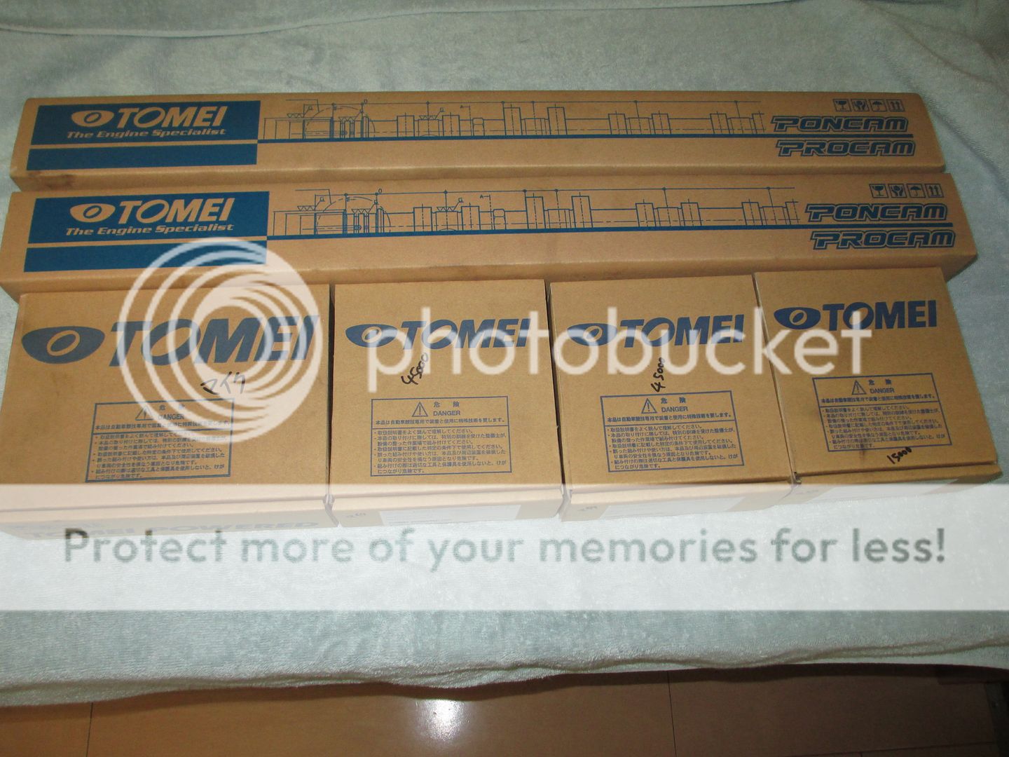

I had to order the cam gears and the lifters myself, this is the rest of the package. First the valve springs.

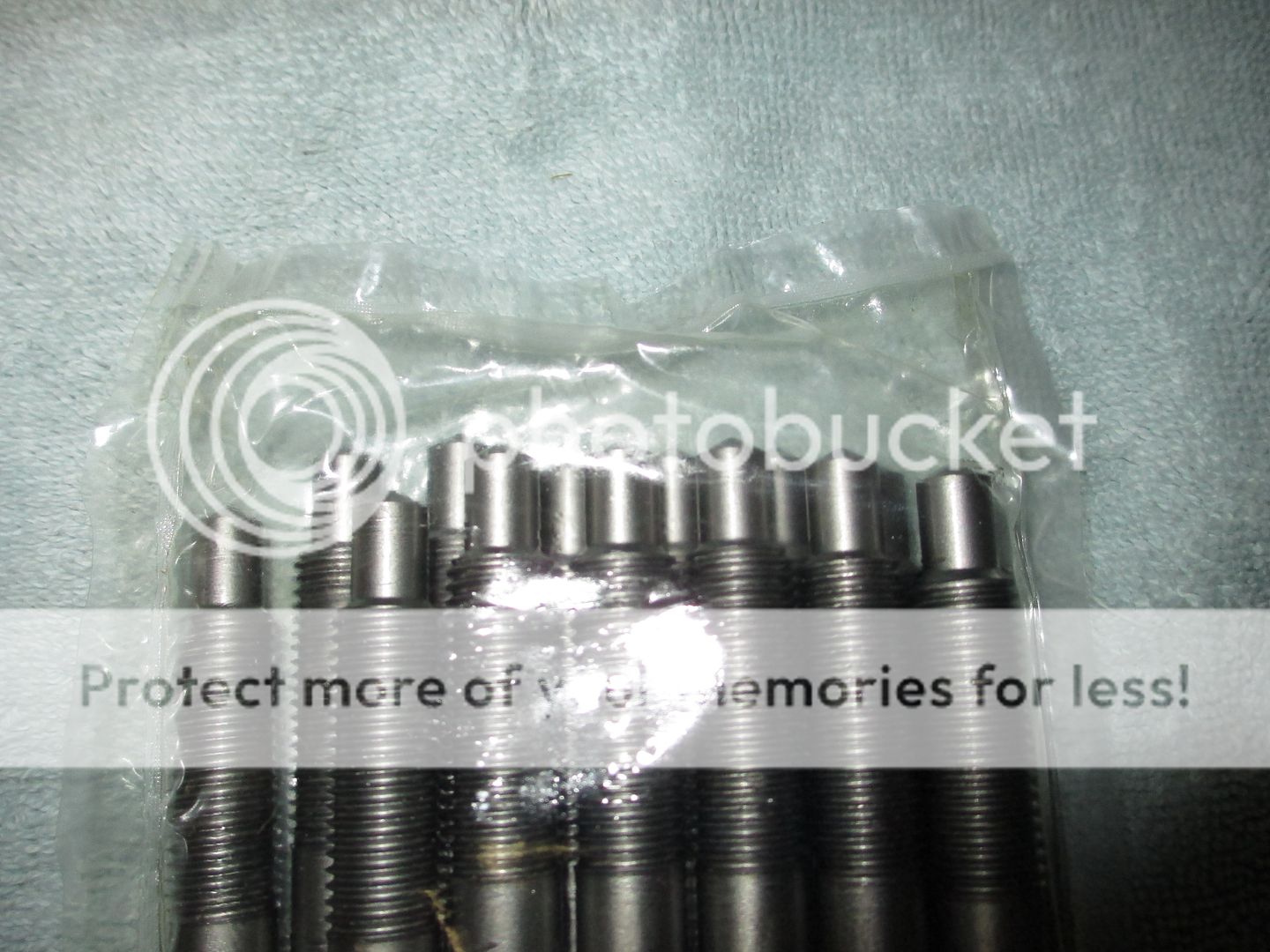

Now all the studs to hold the business together.

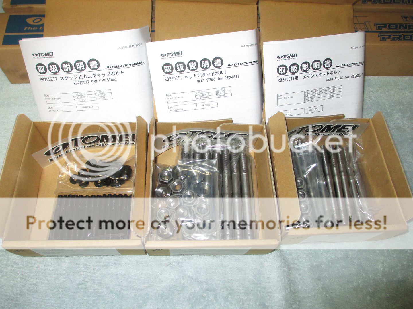

I am using the new ARP head and main studs to bolt the A-Team engine, but the beast gets these. The Tomei units have these posts at the bottoms. They bottom out in the hole to further stabilize the studs.

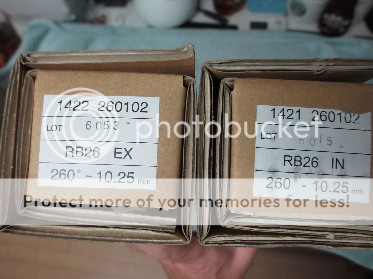

Now the bumpsticks that will orchestrate this show.
The lift is so high the head has to be cut to clear them. This is one of the things Naprec is doing for me.
Be sure to put them in right or you're going to have a bad time.

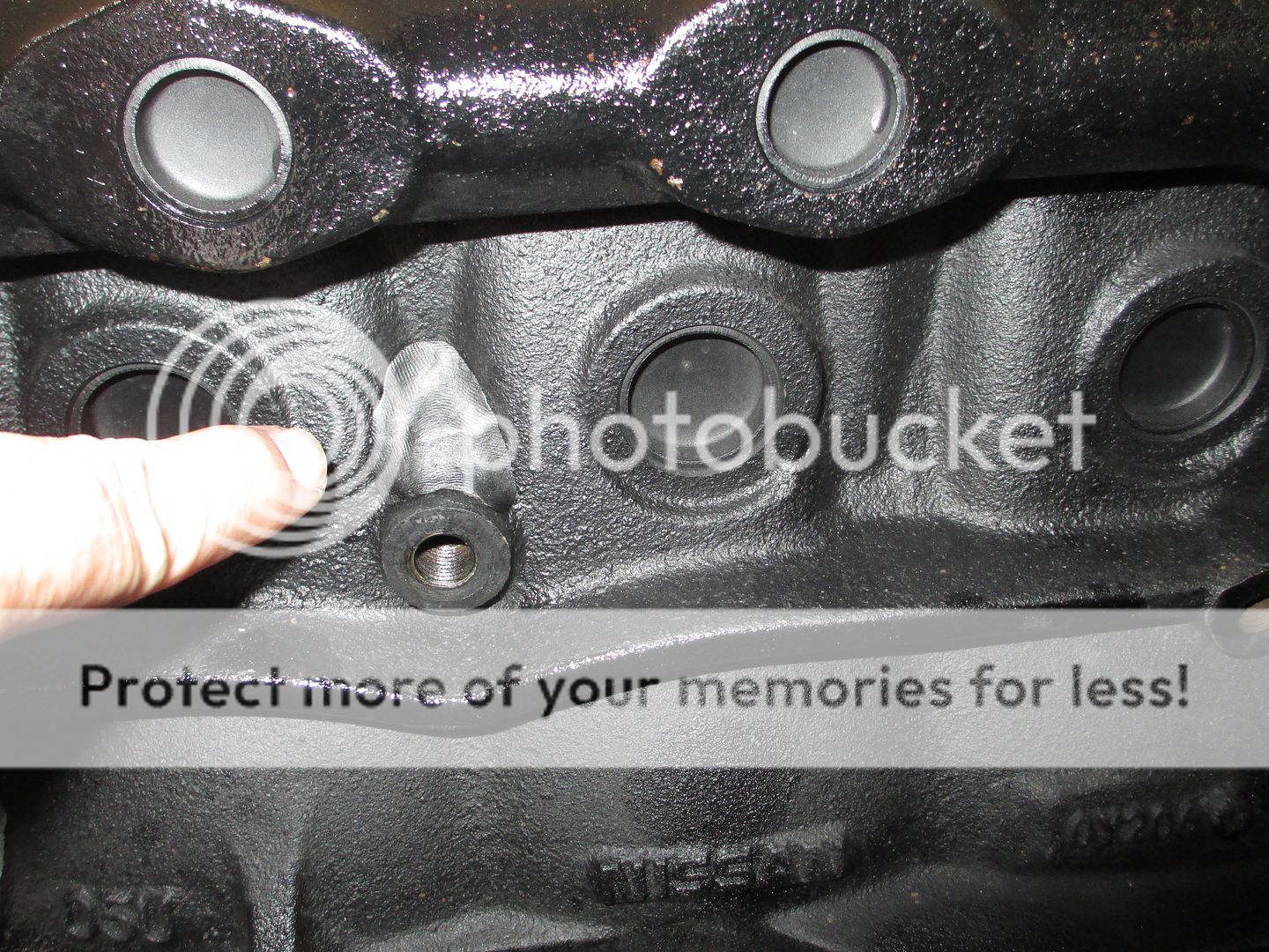

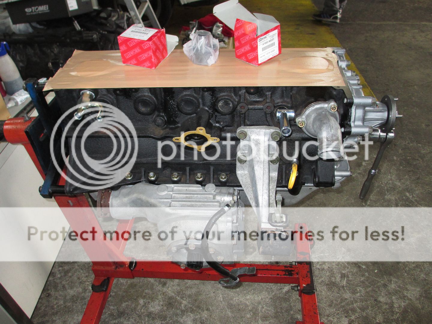

Yeah, all bolted in. Wait, what, why is it BOLTED in? Remember these?
I know I gave him the main studs and ONLY the main studs. These guys are so disorganized I don't trust them to hold any of my parts that they aren't going to be installing immediately. They are nice guys, but, seriously, I've seen an 8 year old run a lemonade stand with more oversight. So I ask him if it's in for good or just mocked up. He says It's in for good. I ask why he used bolts. He gives me a dumb look. I have gotten to the point of not replying to painfully obvious questions so I give him a Red Foreman, newspaper down "dumbass" look. Hey, whaddayaknow, he gets there all by himself "you gave me head studs," I just swing my head slowly back and forth. He runs over to my parts pile, pulls the ARP box out, reads it, opens it and starts talking about some unrelated shit while he fires up his air ratchet and starts unscrewing the stock main bolts. Fearing I might loop the air hose around his neck and choke him out I walked out.
Dude, please pull your head out of your ass before I drop that GT-R off the lift onto your head. I am paying you to do a job and you are fucking up at every turn. It's no longer that dream I had all those years ago, it's like a bad colonoscopy and you already have the camera up my ass. Focus, motherfucker, go blanka and finish this better than anything you have ever done and give me back my car with no BS. I promise to bite my lip and let you finish poking around in my ass just so I can be done with it. Make sure every bolt was tightened, every task completed and nothing, NOTHING, will fail due to a dumb mistake you made. Hey, if the block leaks, it was cracked. I chose to take that risk, not your fault. An improperly torqued bolt comes loose and grenades my engine, though, and we are going to have a serious problem. I promise I will come by CONSTANTLY and check EVERYTHING you do to "help" you achieve greatness for both our sakes. You can tell your buddy to quit giving me the stinkeye when I do too. If you weren't fucking up all the time I would still have confidence in you. You killed that now here we are. It's my money, it's my car and you are a scatterbrain. I am now an auditor, fine. I think you can do a good job if I look over your shoulder and catch every mistake so that's what I will have to do. I told you to give me my Naprec head back without doing anything else to it for a reason. We will not be working together ever again.

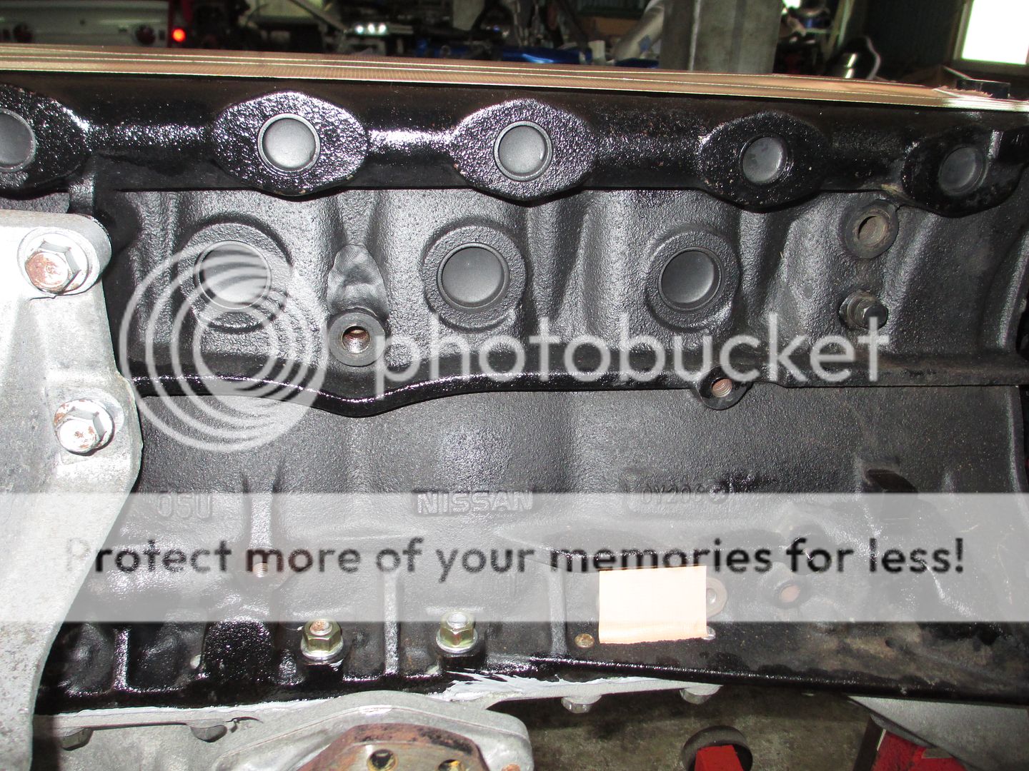

So, I went over there yesterday and when I walked in one guy asked me whether I wanted one or both quench pads cut out. Sensing trouble I sighed "both." He turns to the other guy and says "I told you!" Count, 10,9,8,7,6,5,4,3,2,1, "why do you ask?" The head has arrived back from getting all the mods. Oh, did I say all, how stupid of me. I open the box and sure enough, only the intake pad was cut out. Before I let out the rage I took a moment to admire what had been done, HOLY CRAP! This thing is sexy! The CNC work is a thing of beauty. Ok, though, time to lose my cool. They start apologizing profusely and I say "fuck it, give it to me."
I've already sort of showed my displeasure several times so they step back then insist they can send it back at no extra charge, but I just walk away and start looking at my boss' car; he's got the same turbo I'm ordering, I'm visualizing, happy. They try to use my boss to translate what they are saying. He's like "he understands you, why are you talking to me?" Finally they whine so much I'll do anything to make the shit stop so I just point at the box on the shop floor and say "do it then and while you're at it send the other head out already, why is it still here?"
Now, I swing by Nissan today to pick up my grab bag of little odds and ends; you know, all those little oft-forgotten seals and gaskets and crap that you don't remember until you are putting the engine together; I remembered. I brought some of them over, but not all; I don't need them losing this stuff. The short block is coming together.
Oh crap.... Did you see it? How about now?
There.
I am building an improvised explosive device, folks. Yup, this thing is not going to make it to 2017. Hell, my new block that is scheduled to arrive in October should be just in time because the safe money is this engine will be coming right back out with oil and coolant running out of multiple cracks. I'll order some piston rings because I'm going to need them. The upside is because this engine will likely fail within months I doubt the pistons will even be scuffed when they are invariably pulled out. For reasons that should be obvious I will be having that engine built by someone else.
What I would really like to do is bring this block back, put it down on the floor of their shop then go back to my car and come back with my 12lb sledgehammer and smash the block into a pile of metal. I would then wipe off my sledgehammer with their cleanest rag, I like my sledgehammer, and leave and never come back.

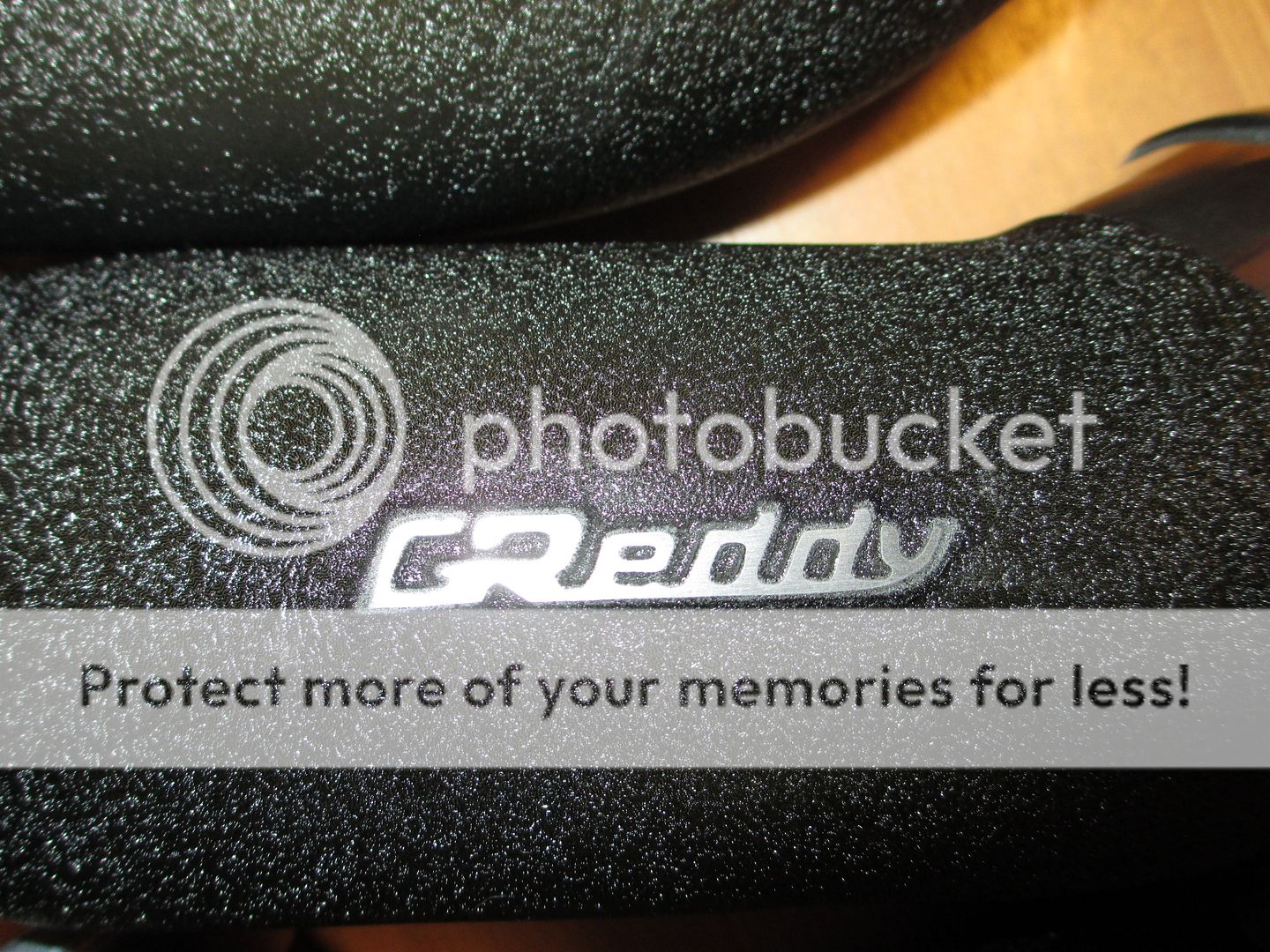

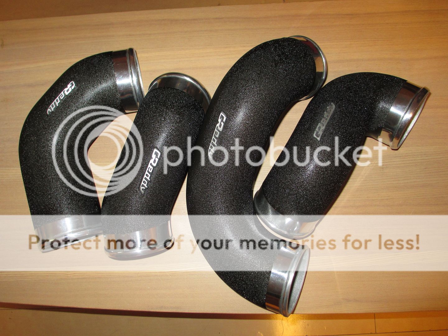

I have been on the fence about doing the intercooler pipes in the same wrinkle black. I came down off the fence and had them done. The GT-R has a mess of pipes and couplers, and twin blow off valve mounts and mess like that; a lot of it long rubber hoses. It looks like crap and it's not good enough. I picked up the Greddy hard pipe kit which replaces a majority of the pipe and hose run with smooth highly polished cast pipes with silicone couplers. They look great right out of the box.
All things being equal I would love to have everything all shiny and polished, but I live close to the ocean and everything rusts even aluminum; white rust. After everything is installed, even if I was the kind of guy to religiously polish stuff, I wouldn't be able to get at most of the shiny stuff. That, combined with the fact that I am NOT the kind of guy to clean stuff regularly even if I could easily reach it led me to powdercoat a lot of stuff. Any place where I can eliminate a maintenance task is advantageous. Gotta coat those pipes too!
To ease hose installation, like the surge tank, I had the coater leave the ends uncoated.
I gave a little nod to the bling and had him leave the cast in Greddy script uncoated too; the contrast really pops.

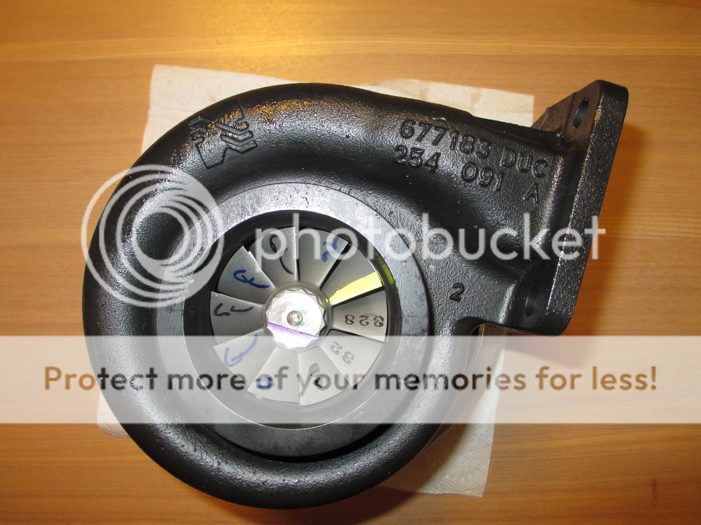

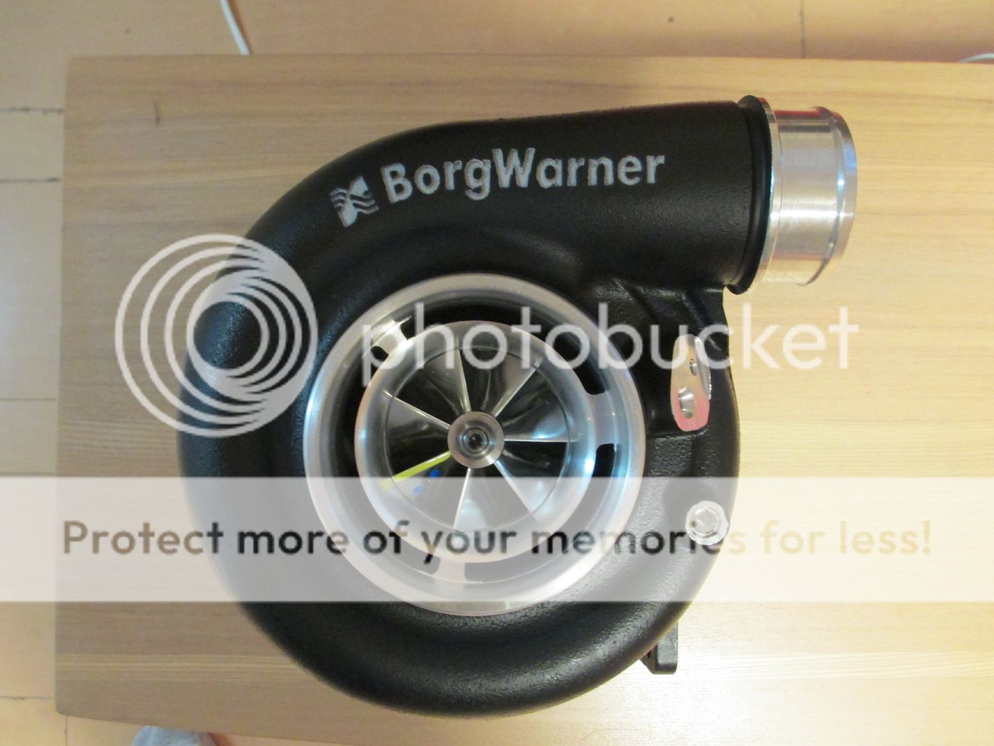

Ok, the new screw arrived. The T78 was acceptable back when the engine build was for a top end car, but with the broken block build and its lower power figure and the focus being on response, that ancient, slow spooling design is a non-starter. No, I want the turbo to scream onto boost. There were a few on the list of possibles. The GTX3582R and the Borg Warner EFR 8374. Both are a little large, but they offset that by being much more efficient than the dated Greddy unit and also have a lot of overhead so I might be able to use them on the next build. Unfortunately, both are not cheap being ball bearing types, are thus not easily rebuildable if something should go wrong. You know, like if you had a sketchy block that might spring a leak at full scream. I'm already risking my stroker kit, I'm not going to double down with a bleeding edge level turbo. I went with the Borg Warner S300 SXE. Here it is next to the T78.
It's a bushing turbo, but has a 360 degree thrust bearing and with the billet wheel, antisurge compressor housing and capability to mount a wheel speed sensor, it's not exactly "settling," but if something goes catastrophically wrong and the turbo gets shredded, I'm out $1200, not $2400. It's the 64.5 wheel and I opted to kick in a little extra to get the black ceramic coating on the exhaust housing. I chose the 0.91 back side to further emphasis response. i can later switch out to a larger backside if this turbo carries over to the next build and I want to see just how crazy it can get.
