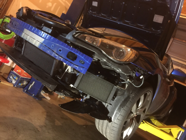

Originally Posted by NotSoJDM View Post
Attachment 129208
I fabbed up a system using a Mocal Tstat plate and Setrab 6 Series Cooler with -10AN lines.
This is a super long shot, but is there anyway you can either get a photo (if youre still running it) of the brackets you made to mount the oil cooler. Or maybe describe them as best you can?
the one side seems simple enough, it just bolts to the crash beam. But the one that goes near the light has me baffled.
I was considering mounting it at an angle by the radiator stack, but I am concerned that it will either not get enough air or add to much heat to everything else.
Gloonge is offline   Reply With Quote
