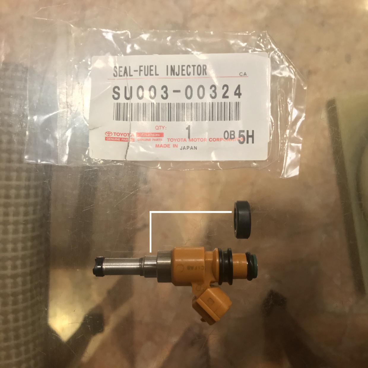

Old 04-24-2020, 02:26 PM   #378
im.rocketeer
Join Date: Mar 2020
Drives: 2013 Toyota-86
Location: Bangladesh
Posts: 18
Thanked 5 Times in 5 Posts
Hi guys! im having some problems relating the injectors.
1.identifying the type of injector I have so that I can find some instructions on google. I have uploaded some pictures of my injectors.
2.I ordered few parts including the seal but im having some confusion in knowing where does the O-ring like part actually fits in my injectors
would be great help if anyone can help me with this..
Cheers guys!
im.rocketeer is offline   Reply With Quote
