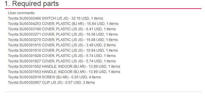

Welp, I just added everything up and placed an "inquiry" with Amayama.. I hope these are all the right parts:

I got approved by Amayama yesterday. I ordered every single black replacement part (including the door handles and grips both) which you can see a few posts back. My total ended up being $190 shipped.

Yes. It took 3 - 4 days before they finalized my order and said it was ready to be reviewed (with the shipping costs included). The initial order is called an "inquiry" with them.

I've owed these to you guys for too long. Interior isn't pristine but hopefully it gives you an idea of what full OEM black looks like.
So that this is all in one place rather than 3 posts.
Here is my order list:
1 COVER, PLASTIC Toyota SU00303270 1 - Right door handle
2 COVER, PLASTIC Toyota SU00303271 1 - Left door handle
3 HANDLE, INDOOR Toyota SU00301562 1 - Right door lever (with lock)
4 HANDLE, INDOOR Toyota SU00301563 1 - Left door lever (with lock)
5 COVER, PLASTIC Toyota SU00301927 1 - Right Knee Pad garnish
6 COVER, PLASTIC Toyota SU00301928 1 - Left Knee Pad garnish
7 COVER, PLASTIC Toyota SU00301932 1 - Dash trim (passenger dash)
8 COVER, PLASTIC Toyota SU00301910 1 - Dash trim (radio surround)
9 COVER, PLASTIC Toyota SU00303190 1 - Shifter surround
10 COVER, PLASTIC Toyota SU00301915 2 - AC vent covers. (you need 2 of these)
11 COVER, PLASTIC Toyota SU00304253 1 - Steering wheel trim
12 SWITCH Toyota SU00302486 1 - Buttons (traction control/sport) (manual)
13 CLIP Toyota SU00302967 5 - Extra clips
Total price was $205, shipping was $42, they didn't ask for a VIN.
I got this set of tools from Amazon for $20. I only used about 3-4 tools, so a smaller set would probably work just fine:
[ame="http://www.amazon.com/Astro-Pneumatic-4524-Fastener-11-Piece/dp/B005NMCE04/ref=sr_1_6?ie=UTF8&qid=1367544089&sr=8-6&keywords=dash+removal+tool"]Astro Pneumatic 4524 Auto Fastener and Molding Removal Tool Set, 11-Piece - Amazon.com[/ame]
Some DIYs and videos that helped me:
Door card removal: http://www.ft86club.com/forums/showthread.php?t=12520
Once you get the screws out, don't be afraid to just pop the door off with medium force. Start at the edge where you removed the push lock. The door handle comes out easy enough, you just unmount the cables from the handle and then they slide right out.
Inner HVAC garnish: http://www.ft86club.com/forums/showthread.php?t=13583
Just use the JDM knee pad removal DIY since you need to do all that to get to the garnish. It was the longest part of the install.
Vent rings: Just get a tool under them and pop them off.
Door handle garnish: See Door card removal.
Radio/dash panel: See JDM knee pad DIY. Of note, the radio piece needs to be flexed a bit on the bottom to line the tab up so that it inserts back into the dash. If you snap it right in it will look like it doesn't cover the gap between the HVAC panel and the radio.
Sport/Trac buttons: See JDM knee pad DIY.
Shifter garnish: See JDM knee pad DIY.
