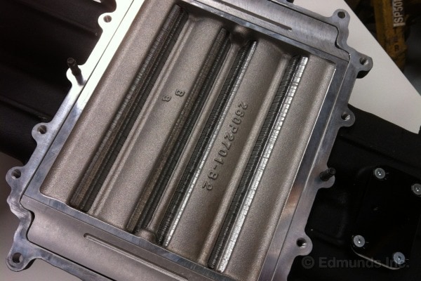

AFR is going lean at higher RPM's. No vacuum leaks could be found. I spoke with Bill @ Delicious and after reviewing my logs he didn't see anything out of the ordinary (other than the lean condition). He suggested the two seals that go on top of the IC (pictured below, the ones that go in the machined channels at the top and bottom) can sometimes leak, so that's what I'm verifying.
My intercooler kit didn't come with seals for those 2 channels. What exactly are those channels sealing?
Not sure what exactly their purpose is, but here's a photo from the sprintex install manual
You apply silicone to the 4 posts to prevent them from damaging the core. I've heard issues of the cooler cracking due to banging on the posts.
While you have the cooler out, if you can take to your nearest radiator shop and have them pressure test the cooler. That's where I found my leak.
There 4 tubes in the core each have o rings, which did not seal.
Test under 1 bar up to 1.5 bar pressure under water.
Use your adapter plugs in the cooler, that will also tell you if they sealing.

I'm referring to the rubber strips that fit in the grooves on top of the laminova core
