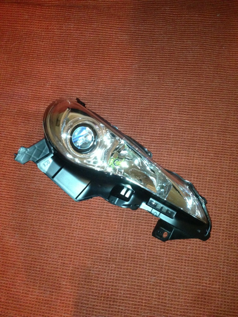

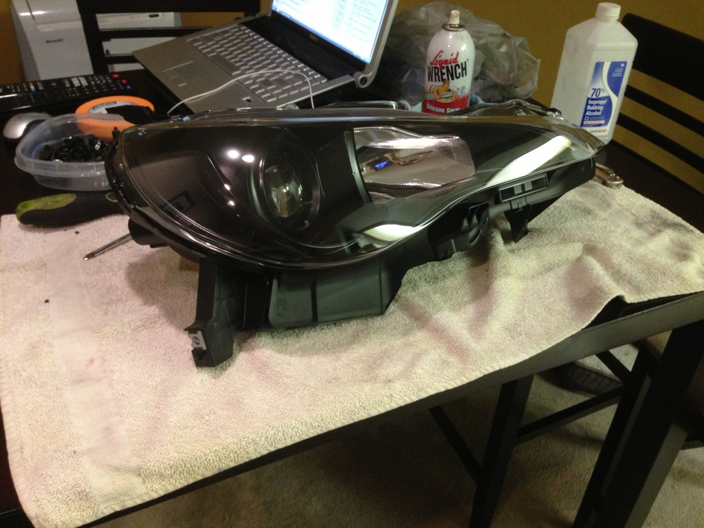

My contribution. I'll post full pics when I can

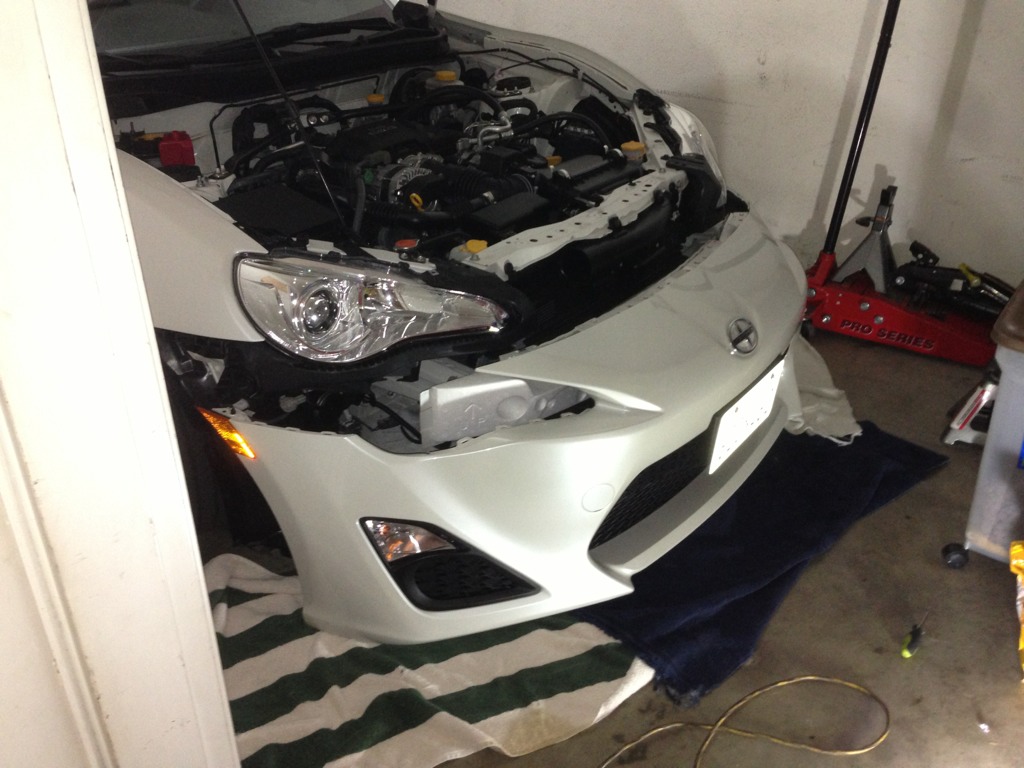

Final
@White-Out, don't remove them while pulling it off. There is a little plastic tab up there that you just need a small screw driver to get to. Once the bumper is off, pull them then. You will see the metal tabs better then. I used a screw driver to push them in and the light came out pretty easily. Look in my first pic with the bumper off. They are still all the way in
